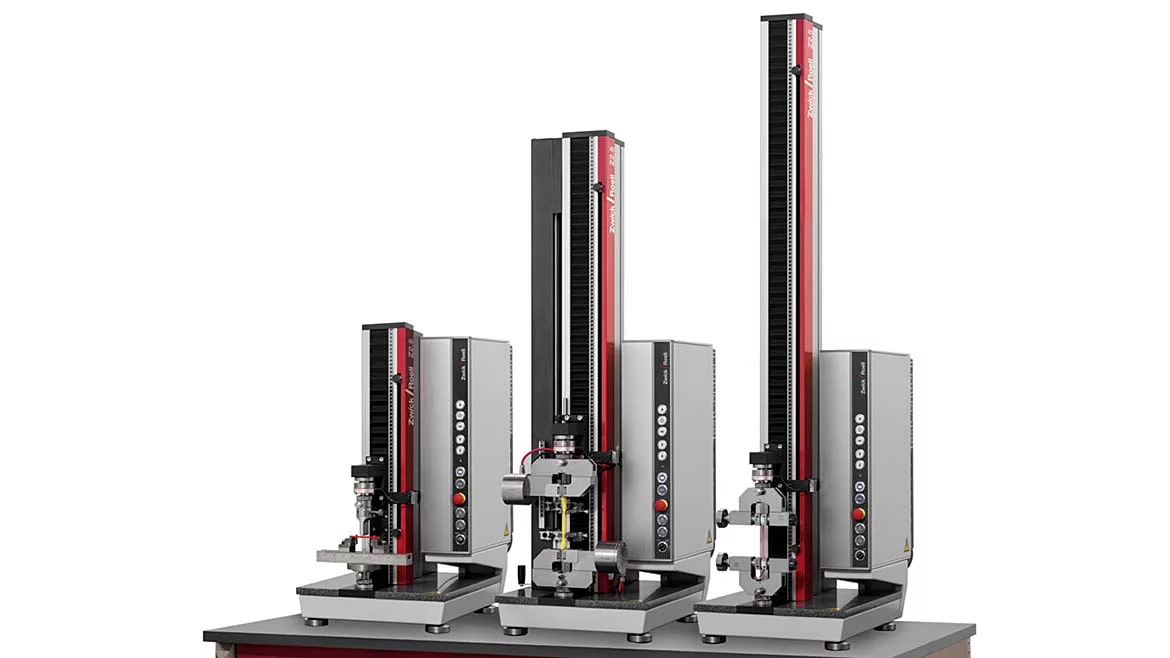

Tensile Testing (No. 1 of 3)
Tensile testing is foundational for the determination of core material properties of extruded catheter tubing and materials for guidewires and stents, for example. Whether we look at large urological catheter materials made of polyethylene or ultra-small tubing targeting neurovascular applications, the desired results and the test systems required to deliver them are quite similar. Typical required test parameters and results include wall thickness (and the reference inner and outer diameters), peak or break load (and resulting stress when including wall thickness and total specimen area), breaking load (stress) and sometimes modulus. Occasionally, testing at body temperature (37 C or 98 F) may be necessary to get a more well-rounded view of the catheter function either in air or in liquid media such as saline.
Typical tensile tests are performed on a universal testing system. First, you must consider the overall travel that your sample or interventional product will require during testing. Ideal systems are available in several heights to create flexibility in configuration. Next, pneumatic grips with special line contacting rubber finishes ensure that test slippage is minimized during testing. Lastly, a long travel extensometer provides high resolution information so calculations of strain at break as well as modulus can be performed automatically. Optionally, the entire system can be encapsulated in a 37 C temperature chamber to provide all results at room or elevated temperatures.
All forces, speeds, displacements, strains, and temperature should be calibrated on an annual basis in accordance with ASTM E4. The actual test can be performed by using state-of-the-art testing software that can be configured to meet regulatory requirements mandated by the 21 CFR Part 11 standard.
