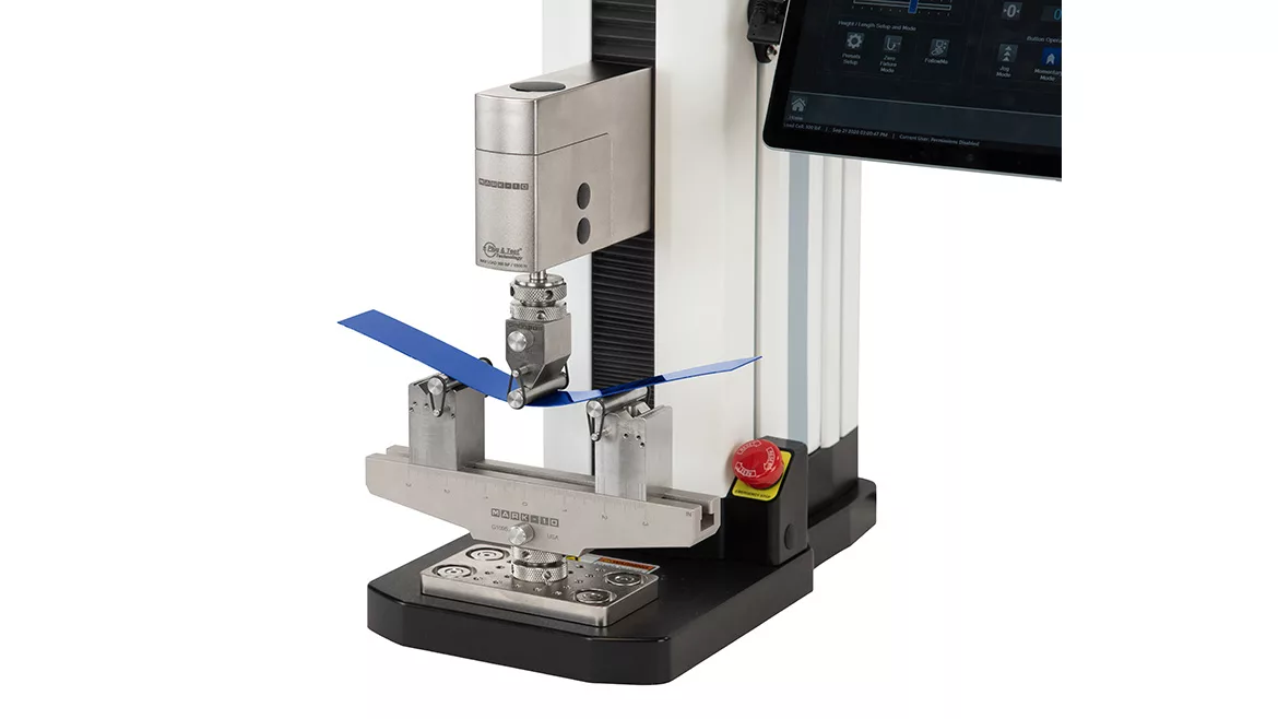

In materials testing, the flexural modulus, also known as the bending modulus or modulus of elasticity in bending provides insight into the flexibility of a material of specific geometry.
The flexural modulus is evaluated through a three-point or four-point bending test. A variety of bending fixtures have been developed where a sample is subjected to a bending load, causing a deflection. The relationship between the applied load and deflection determines the flexural modulus.
Bend fixtures can be fitted with one or two points, to accomplish a three- or four-point test. Blocks containing anvils can be positioned along the length of the fixture to widen or narrow the spacing as specified by the test method. Anvils of various diameters are also available, and may be interchangeable with certain block types.
Flexural modulus is calculated as follows:
Eflex = L3F ÷ 4wh3d
L = length between bottom fixture supports (span)
F = force (load)
w = sample width
h = height (sample thickness)
d = distance traveled (sample deflection)
