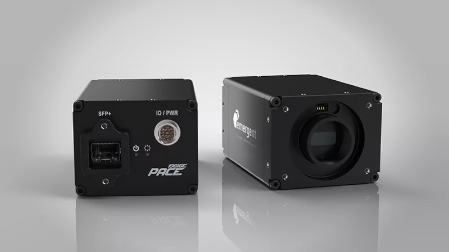

Emergent Vision Technologies introduces a new 10GigE line scan camera, the PACE LR-4KG35. Through its 10GigE SFP+ interface, the camera reaches a top single line rate of 172KHz.
The LR-4KG35 line scan camera features the 4Kx2 Gpixel GL3504 CMOS image sensor, with a 3.5x3.5µm pixel cell size and a 14.336 mm sensor scanning width. Both GigE Vision and GenICam compliant, the camera allows cable lengths from 1M up to 10KM without the need for costly fiber converters/repeaters.
The LR-4KG35 10GigE line scan camera also provides both 8-bit and 10-bit modes with 4Kx2 resolution and a dynamic range of 66 dB. Available in both monochrome (LR-4KG35-M) and color (LR-4KG35-C) versions, the cameras can be used with Windows 7, 8, and 10 and Linux (64 bit) operating systems for maximum compatibility. The PACE LR-4KG35 10GigE camera delivers high-speed, low-noise image capture at 4K vision to ensure that all inspection, sorting, and production control requirements are met. While currently supporting the GigE Vision Streaming Protocol (GVSP), the LR-4KG35 camera — like all Emergent cameras — is RDMA (remote direct memory access) ready.
Designed to allow end users to get the most out of their GigE Vision cameras, Emergent’s network interface cards (NICs) are offered in 10GigE, 25GigE, and 100GigE models. These NICs deliver optimal performance for any video stream with minimal system memory utilization, along with low-latency and low-jitter capabilities. The NICs also feature real-time, front-panel 5 V TTL trigger input for added flexibility, support for GVSP and for Windows and Linux operating systems, GPUDirect technology, and camera multiplexing and multicasting with switches.
