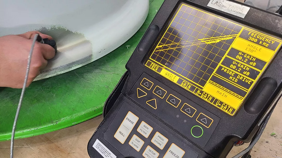

ET, which works by placing an excitation coil in contact on a component. The coil generates a changing magnetic field using an alternating current, which interacts with the part and generates eddy currents. Fluctuations in the current responses are monitored and interpreted as acceptable or unacceptable.

During the minor repair, ET, MT, PT, and VT are used. VT is used for an overall inspection for general condition and ET is used to detect cracks and cracklike flaws in the bead seat. The entire bead seat, for both the inboard and outboard halves are inspected thoroughly. The actual area of interest is the entire radius where the tire contacts the bead seat. The high stress of landings and especially hard landings is transferred to the wheel by the tire in this contact area. This area is especially prone to very small and tight cracking and if there are any cracks discovered, the wheel is deemed unserviceable. The bolts are also tested at this stage for cracking using MT and UT.

During the major overhaul both wheel halves, each tie bolt, each drive key, and the heat shield are inspected. The heat shield is inspected with VT. Each heat shield is provided with an extensive visual inspection where any irregularity is noted. The wheel halves’ bead seats are inspected the same as during the minor repair, but there are also additional ET inspections of the wheel hub and bolt holes on some of the part numbers. For the hubs, the mating surfaces of wheel hubs are inspected for any indications of cracking or initialization of corrosion. For the bolt holes, the adjacent regions around each hole are inspected for any signs of cracking. For both inspections, a handheld pencil type probe is used. Some specific part numbers also call out for a UT inspection of the hub. In these cases, the bearing seat area is inspected using a specialized angle beam UT procedure that ensures that no internal cracking is present.
