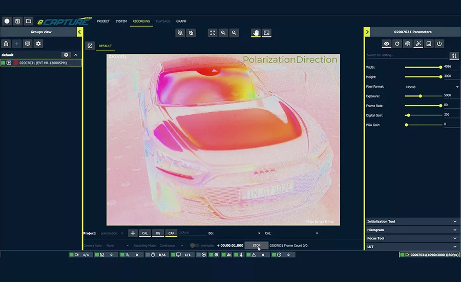

In eCapture Pro software, end users can create their own custom plug-ins or use Emergent’s built-in plug-ins, including a polarization plug-in tool. This tool lets users review the benefits of the characteristic outputs of a standard polarized processing pipeline, such as degree of polarization or direction or angle of polarization. End users can even remove the polarized light or output one of the four orientation options: 0, 45, 90, or 135 degrees.
