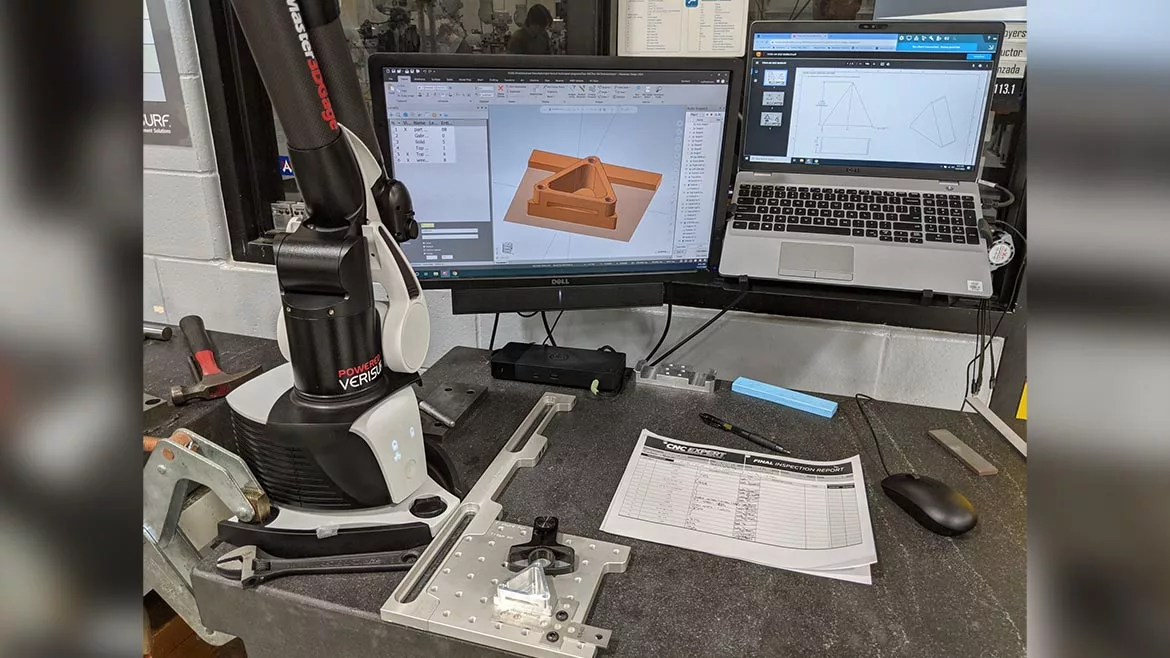

The Challenge
Traditionally, inspecting student-produced parts in a manufacturing education environment has been a cumbersome process. The absence of fixtures and gages often necessitated time-consuming methods such as hot gluing parts to tables. This not only consumed valuable instructional time but also hindered the fluidity of the learning experience. Recognizing this challenge, our institution sought a solution that would provide both accuracy and efficiency in the inspection of student parts.
The Solution
Inspection Arsenal is a versatile and innovative fixturing solution designed to address the unique needs of manufacturing inspection. The system is built with adaptability in mind, allowing for quick-swaps and repeatable inspection of a variety of parts without the need for time-consuming setup changes.
Gabe Kooyers Image 2
Implementation at Van Buren Tech
At Van Buren Tech, junior and senior students follow the structured Titans of CNC Academy building block curriculum. To elevate the inspection process, they’ve adopted the Inspection Arsenal fixturing system. Guided by the Titans of CNC Academy’s curriculum, students advance through distinct cutting phases, creating a variety of parts at different stages. In this personalized curriculum, the crucial need for seamless transitions between inspections is emphasized.
Benefits of Inspection Arsenal:
  1. Time Efficiency:
    The fixture plates, strategically organized on a shelf, have revolutionized workflow. Students can now grab a fixture plate and set up inspections within minutes, significantly reducing downtime associated with traditional methods.
  2. Adaptability:
    The versatility of Inspection Arsenal permits inspection of different parts at any given moment, accommodating the dynamic nature of our individualized curriculum.
  3. Ease of Use:
    The user-friendly design of the fixtures ensures that even students with minimal experience can set up inspections quickly and accurately, promoting a seamless learning experience.
  4. Consistent Accuracy:
    Fixed prebuilt setups eliminate variability in the inspection process, ensuring consistent and reliable results across different parts and students.
Students can finish their part on the CNC machine and inspect it with the Master 3D gage CMM within minutes. Having Inspection Arsenal’s CMM fixturing for the Titans of CNC Academy building block projects has revolutionized the CMM process for my students.
