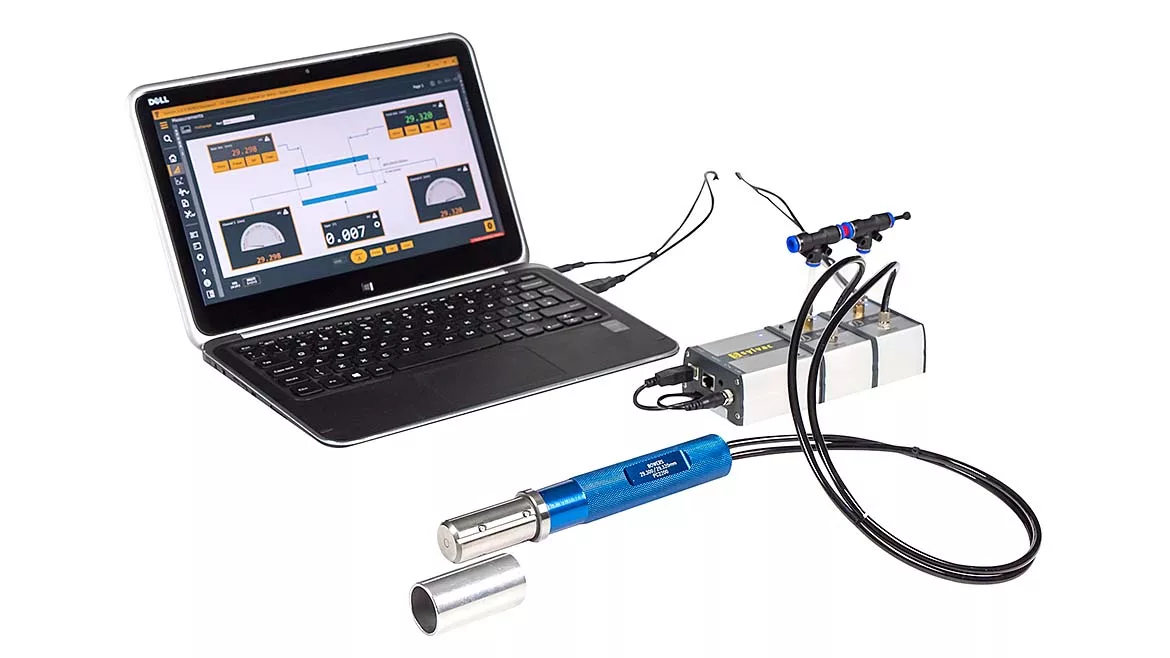

Computer connected Air Gaging

Air gage measuring devices play a crucial role in ensuring precision and quality control in the manufacturing industry. These instruments utilize air pressure as a means of measurement, offering a reliable and accurate way to assess the dimensions and tolerances of machined components.
One of the key advantages of air gaging is its non-contact nature, making it ideal for delicate or easily deformable materials. The basic principle involves directing a controlled stream of air through a nozzle onto the part being measured. The resulting back-pressure or resistance is then measured and correlated with the part’s dimensions.
These devices find extensive use in various manufacturing processes, from automotive to aerospace industries, where tight tolerances and high-quality standards are paramount. Air gages are particularly valuable for applications where traditional contact-based measurement tools might be impractical or risk damaging the components.
Air Gaging Application
Advancements in technology have led to the development of sophisticated air gage systems that offer enhanced accuracy and automation. Modern air gages often integrate electronic components for precise data acquisition and real-time monitoring. Some systems even incorporate computerized controls to streamline the measurement process and provide immediate feedback to operators.
In terms of types, air gages come in various forms, including plug gages, ring gages, and snap gages, each designed for specific measurement tasks. Plug gages, for instance, are used to measure the internal dimensions of holes, while ring gages are employed for external diameter measurements. Snap gages are versatile tools that can measure both internal and external dimensions, making them suitable for a range of applications.
