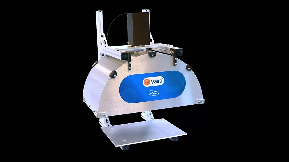

Vaira product with a black background.
Image courtesy of Pleora Technologies

Low-code tools for AI application development are an area of focus for manufacturers, said Ed Goffin, vice president, product marketing, Pleora Technologies.
“As manufacturers get more comfortable with the concept of adding AI to an existing or new process, their attention is turning more to deployment and longer-term cost of ownership,” Goffin said. “One of the key trends we’ve seen, and been a part of, is simplifying development so a quality manager or operator can develop, train, and deploy their own AI application or workflow.”

This typically begins with a template for common requirements, such as object detection, which can be easily customized for the end-user, Goffin explained. This offers a significant cost of ownership benefit for the manufacturer, as they no longer need to contract or hire external expertise to deploy AI in their processes.
“The AI model can also learn from operator input, so instead of programming an algorithm you can train it based on real-time input from an operator,” Goffin said. “In a visual inspection step an operator first accepts or rejects product differences through image compare, while behind the scenes their decisions and associated product images are being used to train an AI model.”
Within a few inspections, the AI model will begin suggesting a decision for the operator, Goffin said. This is especially beneficial for training a system where there can be some subjective decisions around “pass” and “fail.”
