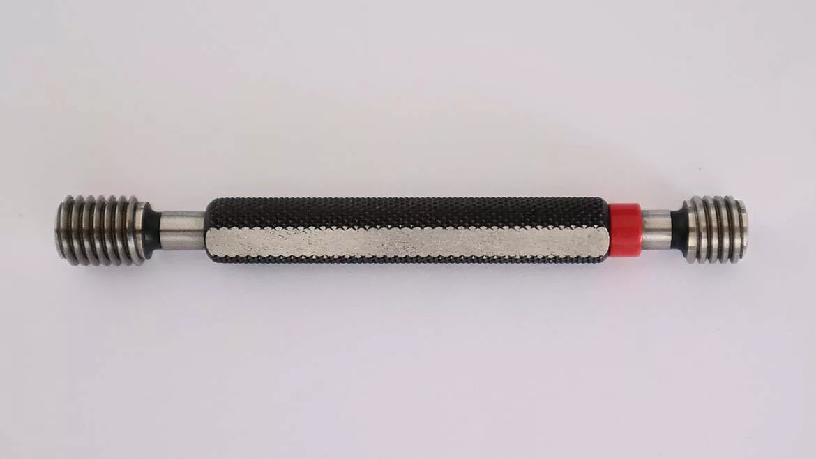

The image shows a go/no-go thread plug gauge, a precision tool used for quality control of internal threads.

To ensure reliable measurements, correct use of your gage is crucial. Cleaning both the gage and parts and applying a light coat of oil before measuring will reduce wear and prevent seizing. When turning your GO gage onto or in a part remember that fingertip pressure is all you need; never force a gage into or onto a part. Remember a GO thread plug isn’t a tap, and a GO ring isn’t a die. Cylindrical plugs and rings might not have threads, but they will scratch, burr, or develop a pickup easily if parts are not clean or are forced.
Remember these Do’s and Don’ts for gaging:
  • Use fingertip pressure – Don’t force or spin a gage
  • Calibrate gages regularly – Don’t use gages past their calibration dates
  • Store gages individually and where they are protected – Don’t store in sunlight or damp spaces
  • Re-inspect gages if dropped – Don’t use damaged gages
