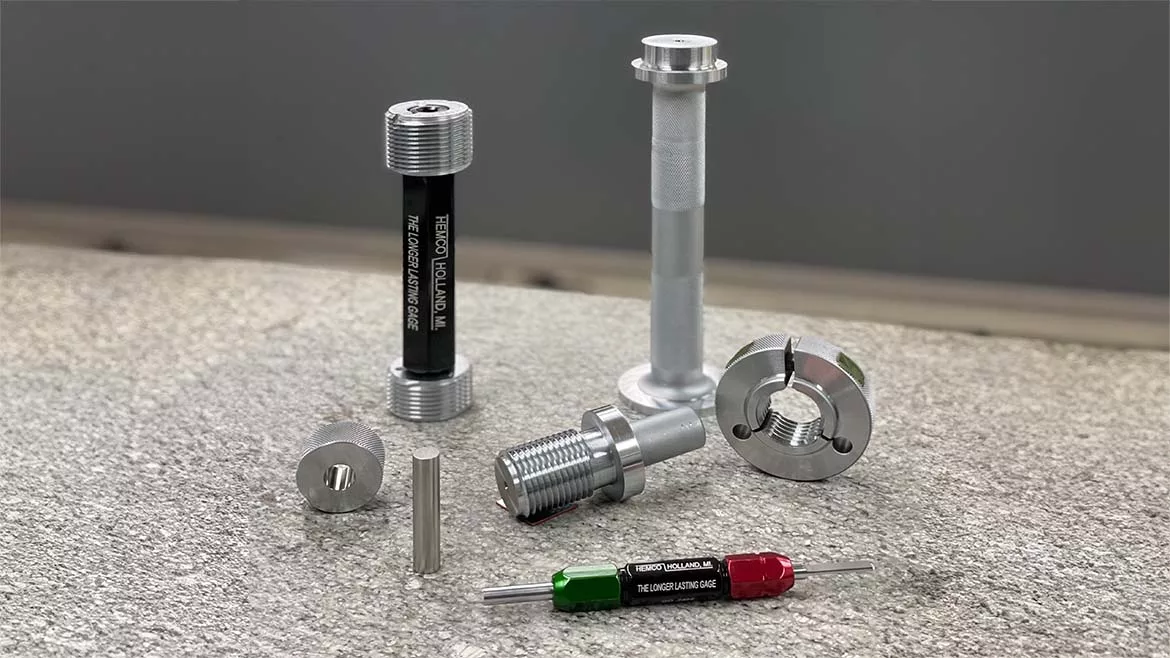

Gaging is indispensable for maintaining product quality and efficiency in manufacturing. By providing a comprehensive assessment of product integrity, gages ensure that parts are accurate and conform to precise specifications. This functional check verifies all dimensions are within tolerance with a single tool, preventing costly errors like rejecting good parts or accepting defective ones.
This article will explore benefits of limit gaging and the advantages of functional gaging.
Limit gaging is to definitively establish whether a particular feature size is functionally within tolerance. Go gages, which pass through a feature, confirm that a maximum material condition has not been exceeded. For instance, a Go plug gage fitting through a drilled hole guarantees the hole isn't undersized. Conversely, Not Go gages verify that a minimum material condition is met. If a Not Go plug gage doesn’t fit a hole, it ensures the hole isn’t oversized. By employing both Go and Not Go gages for both the hole and its mating shaft, manufacturers can accurately determine product tolerances and their maximum and minimum material conditions.

No other gaging system offers the same functional assurance of assimilability between mating parts and product tolerances at such an economical cost. This is why limit gaging remains a cornerstone of quality control.
The Scope of Functional gaging applications span from simple internal diameter checks to complex inspections requiring specialized gaging. The complexity of the gaging process depends on the product and its specific requirements.
When ordering gages, two key factors should be considered:
  • Tolerance Allocation: As a general rule, gages should consume no more than 10% of the product tolerance, with this allocation typically divided equally between Go and Not Go gages.
  • Precision vs. Wear Life: Higher precision gages offer tighter tolerances but often come with reduced wear life and increased cost.
By adhering to these guidelines, manufacturers can optimize gage performance and efficiency.
Functional limit gaging is an essential component of any robust quality control system. By preventing errors, reducing costs, and enhancing product quality, it delivers substantial value to manufacturing operations.
