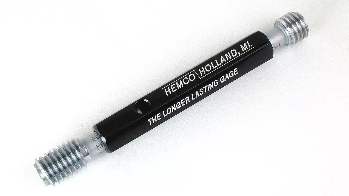

This article delves into the critical aspects of using and caring for thread and cylindrical limit gages to ensure accurate measurements and promote a longer wear life. Contrary to popular belief, limit gages are not indestructible. Gages will nick, scratch, burr, chunks of threads will break off if not handled properly along with changes in size if they are not stored properly.
Storing a gage properly is very important. Gages should always be stored in a manner that protects them from moisture and damage. Gages should always be kept in a clean, dry, and temperature monitored environment. Gages should be dipped in seal-peel, kept in a container, or wrapped in a manner that will protect them from damage. Nicks and burrs resulting from improper storage can significantly impact the gage’s accuracy and reliability.

When applying the gage, use gentle pressure – fingertip pressure is usually sufficient. Avoid forcing the gage as this can cause premature wear, or locking the gage and part together. Align the gage accurately with the product to prevent nicking the first thread or end of the gage.
After each use, return the gage to a clean surface. Never leave a gage on the machine where it can be exposed to coolant, chips, or be knocked to the floor. This could potentially cause major damage to your gage. You never want to hit your gage with a hammer, force your gage into the part, or use your gage as a tap/clean out tool. However, we all know that accidents do happen. When they do, you want to make sure to have the gage checked over and possibly have it sent out for re-calibration. Remember calibration of your gage is the number one way of knowing that you are using a good gage.
