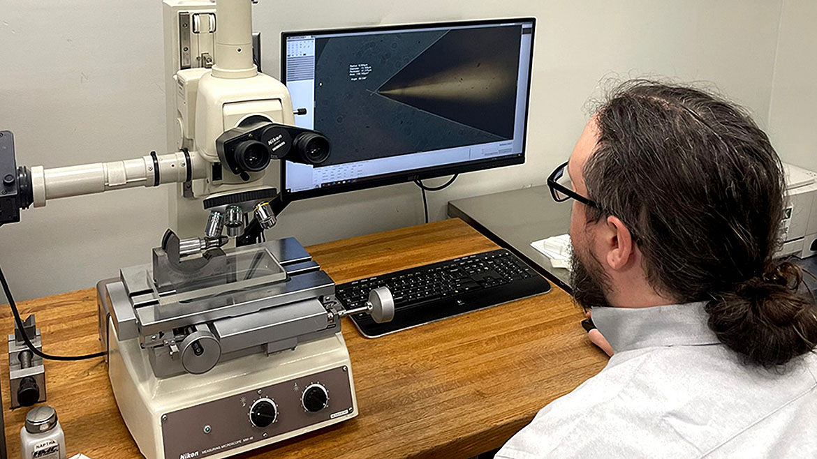

    Figure 3 checking stylus
    Figure 3. Checking the size and condition of a measurement stylus using a high-powered microscope. Image Source: EMI Gage

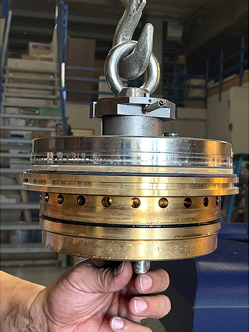

    Figure 5 damaged air bearing
    Figure 5. Dirty shop air led to damage of this roundness gage air bearing. Image Source: EMI Gage
