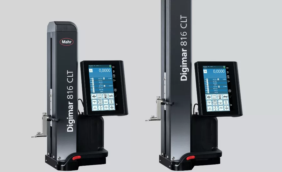

Mahr Inc. announced its new Digimar 816 CLT height gage for accurate measurements in inspection or production areas. The latest addition to Mahr's line of height measuring instruments is equipped with a range of advanced features, including an intuitive touch screen, ergonomic handles, and dynamic measuring functions, designed to offer unparalleled performance and ease of use.
The new Digimar 816 CLT's touch display is designed for intuitive operation. It features extra-large buttons, clearly structured menus, and self-explanatory icons to facilitate a fast and easy user experience, ultimately accelerating the measurement cycle. The Digimar 816 CLT also ensures the reliable completion of measurements, setting, and calculation functions and the creation of measuring programs via drag-and-drop capabilities.
Furthermore, the Digimar 816 CLT offers a secure and convenient data transfer process, allowing for wireless or USB cable data transfer via the MarConnect duplex interface. It also transmits a measuring equipment ID, ensuring measurement results are traceable. An integrated PDF memory enables the creation of complete files directly on the device without the need for additional software or transfer to a computer, streamlining the documentation process.
One of the standout features of the Digimar 816 CLT is its ergonomic design, with handles on both sides and an integrated operating key for precise and smooth air-bearing movement on the measuring plate. This design ensures that the device can be quickly positioned for measurements, enhancing operational efficiency.
Additional features of the Digimar 816 CLT include:
•    An integrated port in the slide to enable measurement of perpendicularity and straightness in conjunction with the Millimess 2000/2001 W digital comparators.
•    Motorized measuring functions for reliable results without manual operator influence.
•    A variety of ports for backing up measuring data.
•    Free MarCom software for seamless data transfer.
•    Available Bluetooth printer for users to quickly print out a series of measurements.
•    A wide range of probes and accessories to make height measurement tasks simpler.
