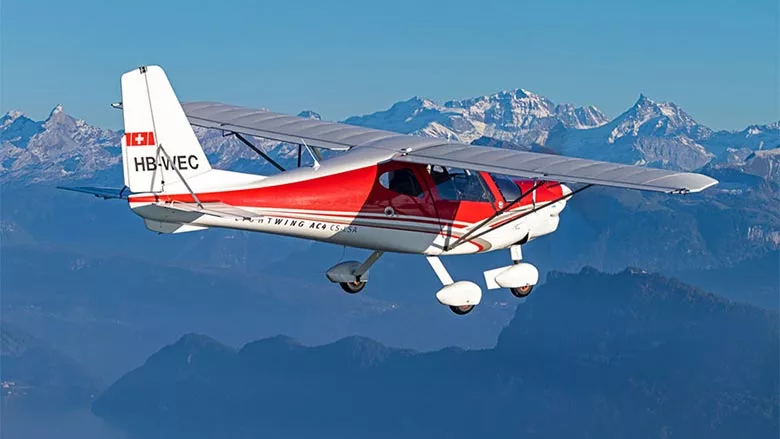

The goal of the H2 project is to equip a Swiss Light Wing AC4 with a fuel cell system that will allow a flight duration of more than two hours and a range of more than 250 kilometers.

Although the e-Sling was successful, the plane offered limited range and flight duration. So, Cellsius immediately embarked on another initiative, the H2 project, to develop an aircraft powered by hydrogen fuel cells. The objective is to equip a Swiss Light Wing AC4 with a fuel cell system that will allow a flight duration of more than two hours and a range of more than 250 kilometers.
