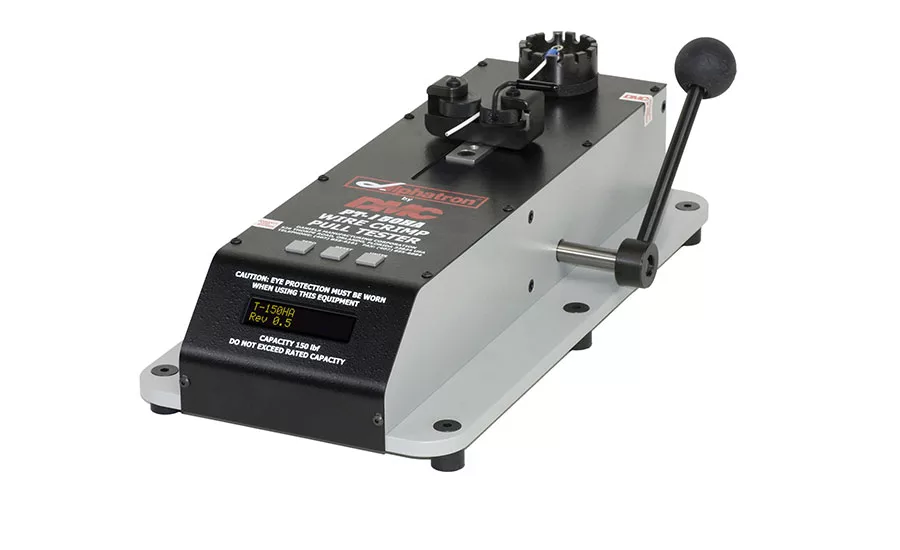

Pull-Tester Checks Crimp Strength
Daniels' PT-150HA manual wire crimp pull tester
Image courtesy of Daniels Manufacturing Corp.
July 26, 2024
The PT-150HA manual wire crimp pull tester is oriented horizontally. It’s ideal for testing crimp strength on wires up to size 10 for Mil-Spec applications and size 4 AWG for commercial and automotive applications. It can measure a maximum load of 150 pounds. It has a resolution of 0.1 pound, and it’s accurate to ±0.5 percent of full scale.
It can be used in conjunction with SPC software and other quality control technology. The digital display is fast and reliable. Gripping jaws and other components can be customized to facilitate installation and removal of test samples.
