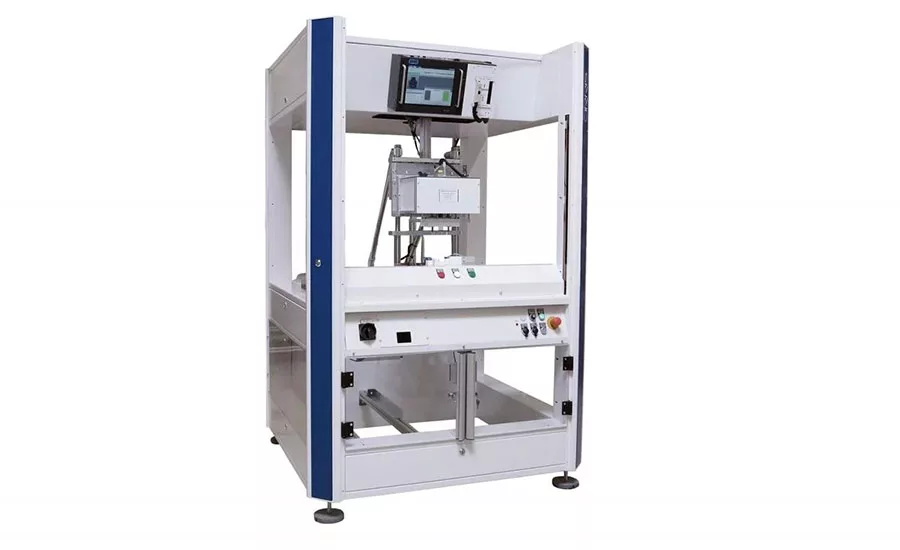

Schleuniger's FlexiTest 2000
Image courtesy of Schleuniger Inc.
July 26, 2024
The FlexiTest 2000 is a basic, flexible platform for automated test and inspection of low-volume electrical assemblies. The cell can be equipped with up to five in-feed axes. The cell is ideal for testing sample parts and pilot production runs. Once the design has been finalized, fixtures and programming for pilot production can be transferred to high-volume test equipment.
The cell can perform a variety of electrical tests, including continuity, high voltage, opens, resistance, reverse polarity, and short circuits. The cell can also check for the presence of parts, such has fastening pins, cable shoes, cable ties, clips, connectors, caps and covers. It can check pin height, pin material and swash circumference, and it can perform vacuum pressure tests and visual checks.
