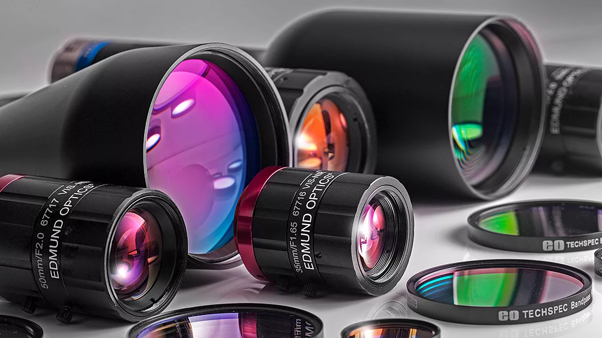

Varying sizes of camera lenses
Image Source: Edmund Optics
