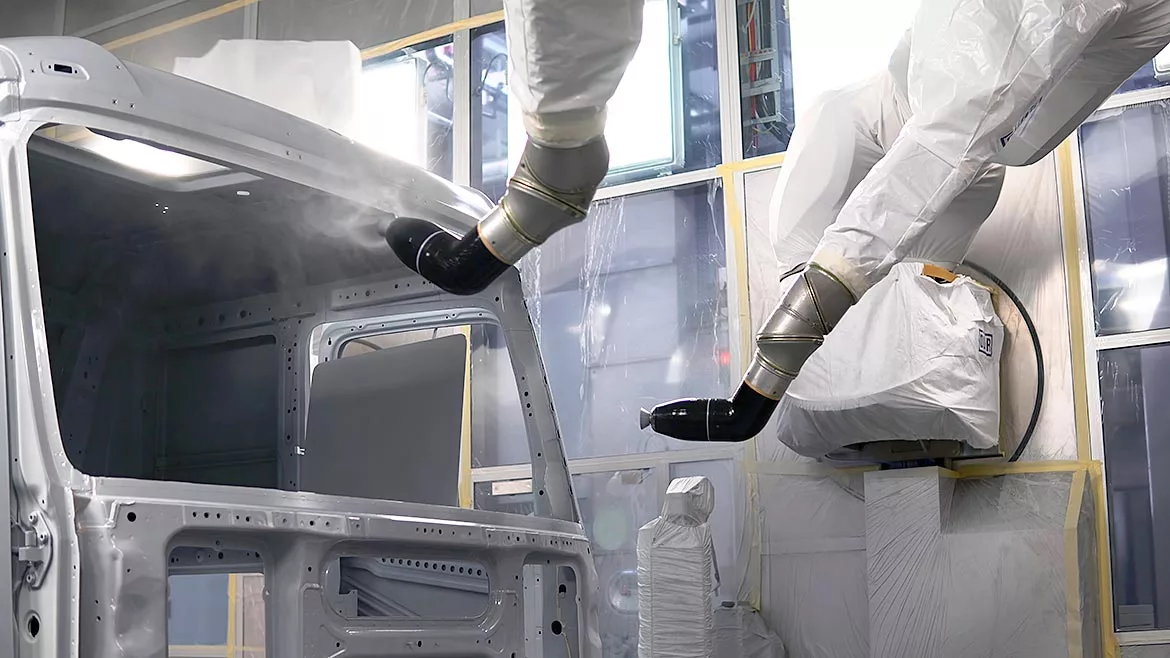

Painting car using robotic machine in production.
Image Source: Media Whalestock / iStock / Getty Images Plus
