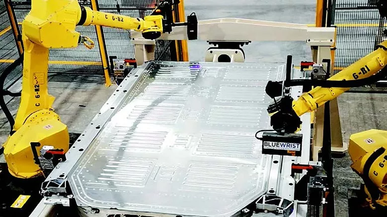

Water is not good for electric vehicle batteries. Water in the battery compartment can cause short circuits, power failure or even fire. As a result, battery enclosures must meet stringent ingress protection ratings, often IP67 or higher.
To meet that rating, the battery compartment must be carefully assembled and meticulously inspected. This was the challenge faced recently by a manufacturer of high-performance EVs. The vehicle’s battery tray requires more than 500 rivets and 100 welds. With an anticipated production volume of more than 65,000 vehicles annually, the inspection cycle for each tray had to be completed in less than 200 seconds.
The tray weighs approximately 80 kilograms and is 4 meters long and 1.5 meters wide. Numerous welds must be completed without any defects before a sealant is applied. This process is essential to produce an airtight, leakproof joint and to create seals that can accommodate the battery pack’s thermal expansion and enable it to withstand vibrations and stress when the vehicle is on the road.
Since the assembly process involves more than 20 steps, quality control must be comprehensive to ensure that defects are identified at an early stage and reworked. If problems are identified too late in the process, the part must be scrapped.
To guarantee structural integrity, each weld must be inspected. Afterwards, the height of each rivet must be checked with an accuracy of ±0.1 millimeter, since the height of the raised round rivet heads determines how much pressure must be applied when the sheets are joined. Finally, various holes, slots and mounts must be inspected to comply with specifications.

Robots Automate Inspection
To accomplish these tasks, the carmaker turned to Bluewrist Inc. in Ann Arbor, MI. Bluewrist developed an inline 3D vision inspection system that can continually monitor production quality.
Working with the OEM, Bluewrist designed a system that uses two six-axis robots from FANUC and two 3D laser profile cameras from LMI Technologies. As the robots carry out high-speed inspection of all the critical features, the results are recorded and a 3D point cloud is processed and verified against specifications to identify any defects.
The profilers capture detailed surface characteristics of each weld. The weld profile can be inspected in its entirety or broken down into individual sections for analysis and comparison against blueprints to guarantee conformity to length, width, throat thickness, and leg length. The system can inspect fillet, lap, butt, corner, T-joint and plug welds.
3D visual inspection
As the robots inspect the assembly, the results are recorded and a 3D point cloud is processed and verified against specifications to identify any defects. Photo courtesy Bluewrist Inc.
Although the OEM opted to mount the profilers on robots, the sensors could be stationary or they could be mounted on linear slides.
The system can detect a variety of welding defects, including burn through, spatter and debris, porosity, cracks, undercuts, discontinuity, and off-location welds.The system can inspect welds at a speed of up to 320 millimeters per second and a resolution of 0.1 millimeter.
Given the complexity of the battery tray, Bluewrist tested the system extensively with feasibility studies before deploying it on the production line. In production, the system performs all the inspections in less than 200 seconds.
When a weld defect is detected, the part is automatically rejected from the production line for rework and analysis without operator intervention. The actual location of the defect is indicated on a CAD model of the part to aid in accurate and efficient rework.
All inspection data and images can be saved for future reporting, record keeping and review purposes as part of a comprehensive quality assurance program. For traceability, information such as a unique number for each weld, part serial number, and cycle time information are all recorded in the database.
