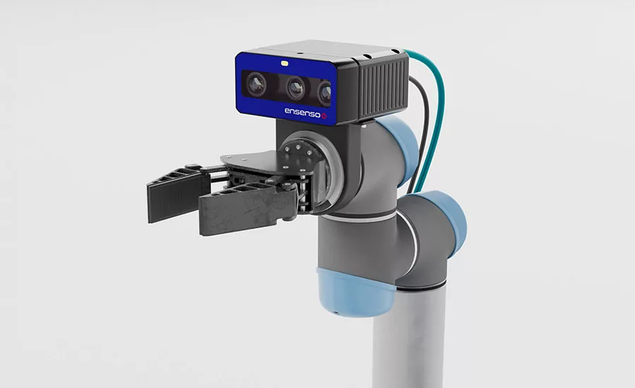

Ensenso B 3D vision camera by IDS
Photo courtesy of IDS Imaging Development Systems

3D Vision Camera for Bin Picking
With its compact, industrial-grade design, short working distance and large field of view, the Ensenso B 3D vision camera is particularly suitable for bin picking applications. Thanks to its high depth of field, it can capture objects over a large area and to localize all parts in a container at once. This optimizes the pick-and-place process and facilitates emptying of containers.
One strength of the camera is its ability to precisely locate objects at close range. It provides a wide field of view and a high depth of field. This means that the area in which an object is sharply imaged is unusually large. At a distance of 30 centimeters between the camera and the object, the Z accuracy is approximately 0.1 millimeter. The maximum working distance is 2 meters.
The housing, which accommodates two 5-megapixel color cameras, a pattern projector and all the electronics, is completely enclosed. This simplifies the cabling. The unit complies with protection class IP65/67. Measuring just 120 by 56 by 104 millimeters, the camera can be mounted to a robot arm.
