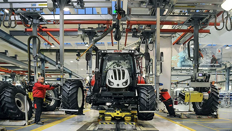

One of those plants is located in St. Valentin, Austria, about 100 miles east of Vienna. Since it opened in 1947, the plant has produced a variety of tractor models, ranging from 100 to 300 hp, under both the Case and Steyr brands. Each tractor takes approximately 40 hours to build, and a finished machine leaves the assembly line every 10 minutes. With 6,400 different specifications, it is rare that any two tractors are the same.

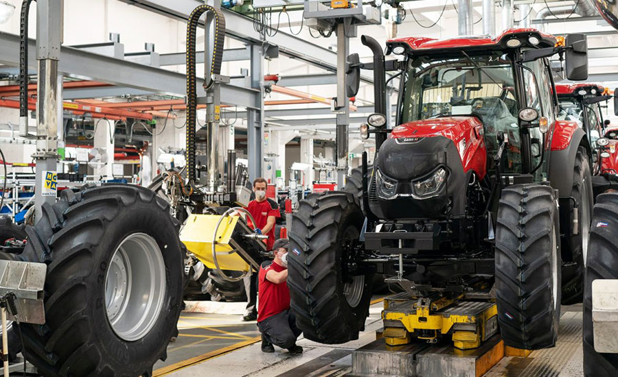

Since each tractor contains thousands of threaded fasteners, CNH engineers must ensure that every screwdriver and nutrunner in the plant is performing perfectly.

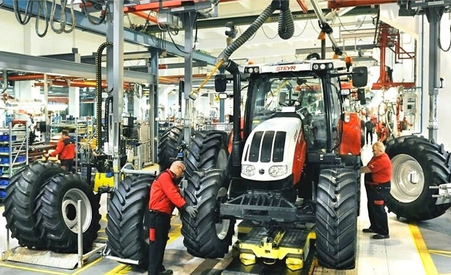

tractor assembly
Software informs the assembly team immediately when predefined fastening parameters are exceeded or not met. Photo courtesy CNH Industrial

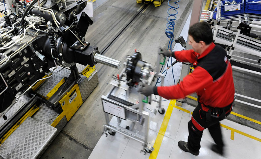

tractor assembly
The software detects anomalies in the fastening data and determines if they are the beginning of a trend or just one-off occurrences. Photo courtesy CNH Industrial
