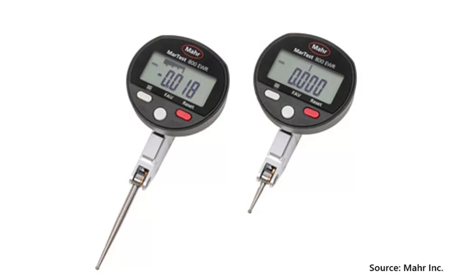

Mahr Inc. announced newly updated MarTest 800 EWR digital test indicators. The new versions of the 800 EWR incorporate an enhanced measuring system that provides longer measuring ranges of up to ±0.035"/±0.9 mm and ±0.086"/±2.2 mm, allowing for better accuracy and versatility.
The MarTest 800 EWR combines the benefits of digital indicators, providing a longer measuring range with high resolution, enabling users to measure faster, more easily, and more reliably while minimizing errors. Combined with the ability to automatically sense measuring direction, rotate the bezel 360°, and overtravel protection features, the 800 EWR test indicator can replace numeral mechanical test indicators. The MarTest 800 EWR’s operating unit is also protected against coolants and lubricants, with a protection class of IP65. Its shockproof design and precision bearing supported lever contact offer maximum reliability in harsh environments. The full-surface glass display provides protection against liquids and dirt, which cannot penetrate the sealed housing.
