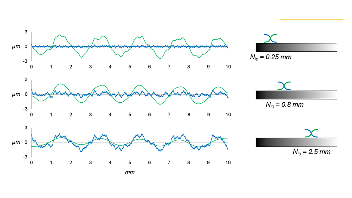

Key Terms of the New Standard
ISO 21920 has some new terms to help with the definition and evaluation of roughness
  • Section Length (lsc): Replaces "sampling length"; a unit over which roughness parameters are calculated.
  • Number of Sections (nsc): Previously "number of sampling lengths."
  • Nesting Index (Nis Nic): A general descriptor for refinement by a mathematical model
  • Setting Class (Scn): Predefined groupings of measurement settings for consistent evaluation.
  • Profile-S Filter: Low-pass filter which corresponds to the waviness filter
  • Profile-L Filter: High-pass filter which corresponds to the roughness filter
Figure 4:  An analysis of how the nesting index changes the resulting profile. Green is longer wavelength components and blue represents shorter wavelength features.
Figure 4: An analysis of how the nesting index changes the resulting profile. Green is longer wavelength components and blue represents shorter wavelength features. Source: Polytec
