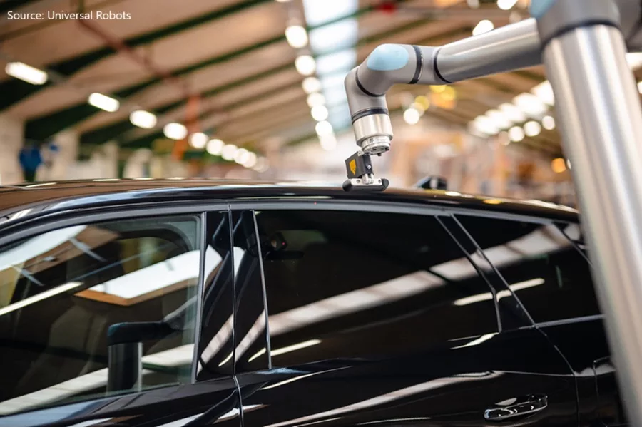

Universal Robots (UR) introduced a new addition to its portfolio, the UR8 Long. Showcased for the first time at FABTECH in Chicago, the long-reach industrial collaborative robot is designed to tackle the most demanding automation challenges across industries. UR8 Long is available for order now, with shipping to begin in October.
With the same 1750 mm (68.9 in) reach as the popular UR20 and a significantly slimmer profile, UR8 Long combines reach, stability and precision in a rugged, compact, lightweight form, featuring an 8 kg (17.6 lbs) payload. This makes it ideal for space-constrained setups and industrial tasks, from complex weldments to precision dunnage picking and flexible multi-point inspections.
”The UR8 Long is a smart robotic arm that can reach farther and do more than ever before. It’s designed to help people and businesses work faster, more safely, and with less physical effort,” said Jean Pierre Hathout, President of Universal Robots. “Whether it’s lifting, moving, or handling tasks that are repetitive or hard on the body, this robot makes the job easier. Its longer reach means it can cover more space, and its advanced features open new ways to automate work that used to be done by hand.”
Advanced technology for synchronized robot motion, intuitive programming and inverted mounting UR8 Long runs with both PolyScope 5 and PolyScope X, UR’s industry-leading software platform, and can be extended with MotionPlus - UR’s new advanced motion control technology that allows for ease of integration with linear axis, rotary positioners and rotary turntables for precise control, smoother trajectories, and consistent accuracy.
Combined with UR’s upgraded freedrive capabilities, users can manually guide the arm with precision and ease - making lead-to-teach programming more intuitive and enabling quick, ergonomic setup even on complex parts, all without the need for layered interfaces or external tools.
UR8 Long’s lighter mass - 30% less than the UR20 - and compact wrist design also makes it perfect for mounting on gantries, rails, or overhead systems, where external axes can operate more efficiently.
With its long reach, advanced motion control and stellar precision and repeatability, UR8 Long is ideal for welding. “UR8 Long delivers an easier teaching experience than traditional welding robots, better weld quality than manual welding, and less overall rework, saving time and money,” said Will Healy III, Global Industry Manager for Fabricated Metals at Teradyne Robotics. “Following feedback from fabricators around the world, the UR8 Long was designed with the collaborative welding process in mind, boosting productivity and helping leaders to attract new talent who are often more motivated to operate a robot than perform repetitive manual welding.”
