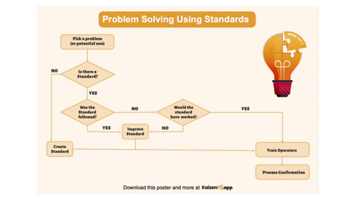

Problem solving. Despite the first two points being unbelievably important, problem solving may actually rise to the top when it comes to answering the question "why do we need standard work?" You only have to be in manufacturing for about 15 minutes before you realize that the only thing you will never run out of is problems! And 99% of them arise because there is no standard in place. Without a standard to review you end up with a group of people standing around a problem asking, "what happened?" According to Dale Carnegie in "How to Win Friends and Influence People" no human being on earth will self-condemn. This loosely translates into, people will have a very hard time admitting they did something wrong and will likely go to great lengths to cover it up. But when there is a standard, you only have two options and one question. The question is: was the standard followed? If they say "no," well problem solved, please follow the standard. If they say "yes," then you simply repeat the process according to the standard, when the defect appears again, you know exactly where in the process and how. Very easy to solve at that point, simply update the SOP and everyone goes back to work. The word "problem" also has a negative connotation, but a problem can be a good thing. And the word can quickly be converted to "Improvement." If you need to increase throughput, make something simpler, or improve quality. Having the ability to examine a standard for opportunities comes in handy. We want to encourage all employees to challenge the standard, not all experiments will work, but when they do, update them and the whole organization benefits from the good idea!
Problem Solving Using Standards poster
Source: Kaizenify.app

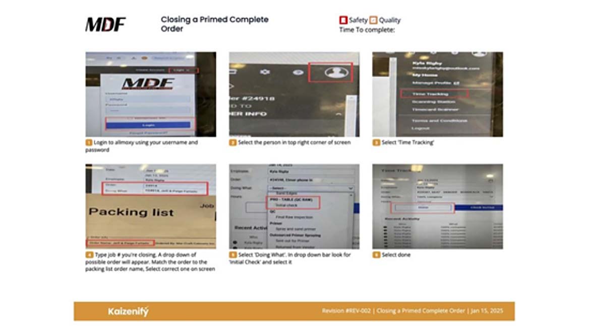

One last pro tip when creating your SOPs. Remember: No one reads anymore. So, you want these elements in every SOP.
  • Big Pictures
  • Brief description
  • A video linked to a QR code
Closing a Primed Complete Order screenshot
