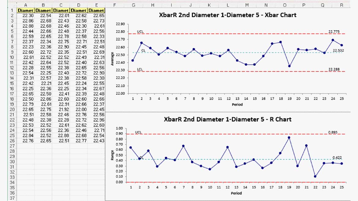

XbarR/XbarS of Piston Diameters (5 samples per subgroup, Figure 2) - Stable Process
Figure 2: XbarR chart of Piston Diameters

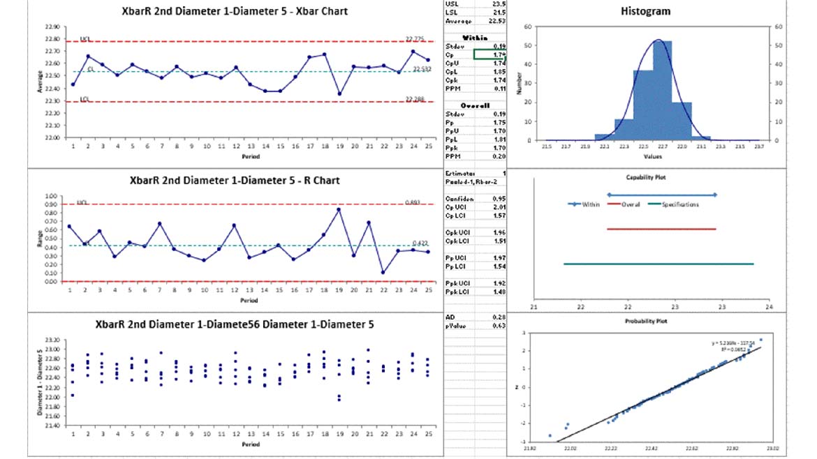

Capability Analysis of Piston Diameters using Capability Suite (Figure 4)
It is possible to do both stability and capability analysis with one group of charts. This capability suite shows Xbar charts, values plot, histogram, capability plot and normal probability plot (data is normal). It also calculates the same Cp and Cpk.
Figure 4: Capability Suite for Piston Diameters

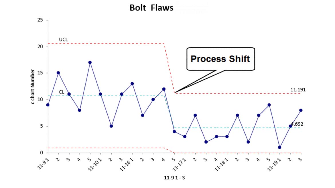

C Chart (pg. 96) – Bolt Flaws Showing Process Shift (Figure 5)
Figure 5: Bolt Flaws c Chart

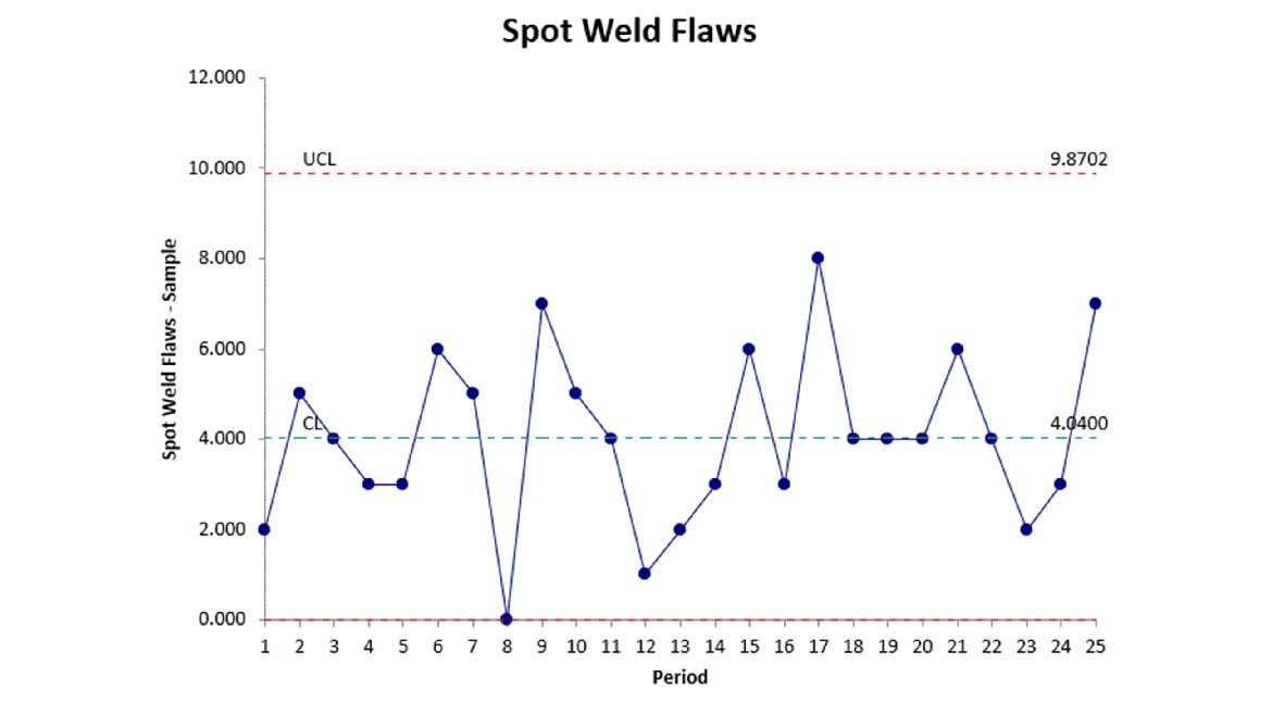

Np Chart (pg. 92) – Spot Weld Flaws (Figure 9)
Figure 9: NP Chart of Spot-Weld Flaws

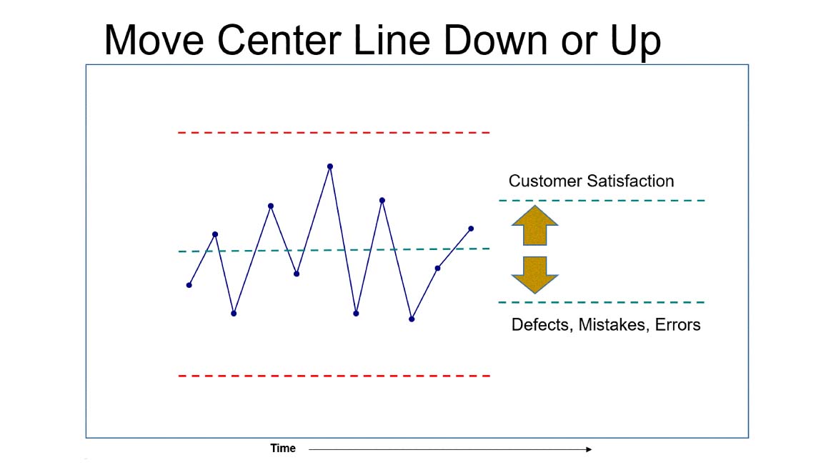

Move the center line up or down to increase satisfaction or reduce defects (Figure 11).
Figure 11: Move the Centerline on Control Charts
