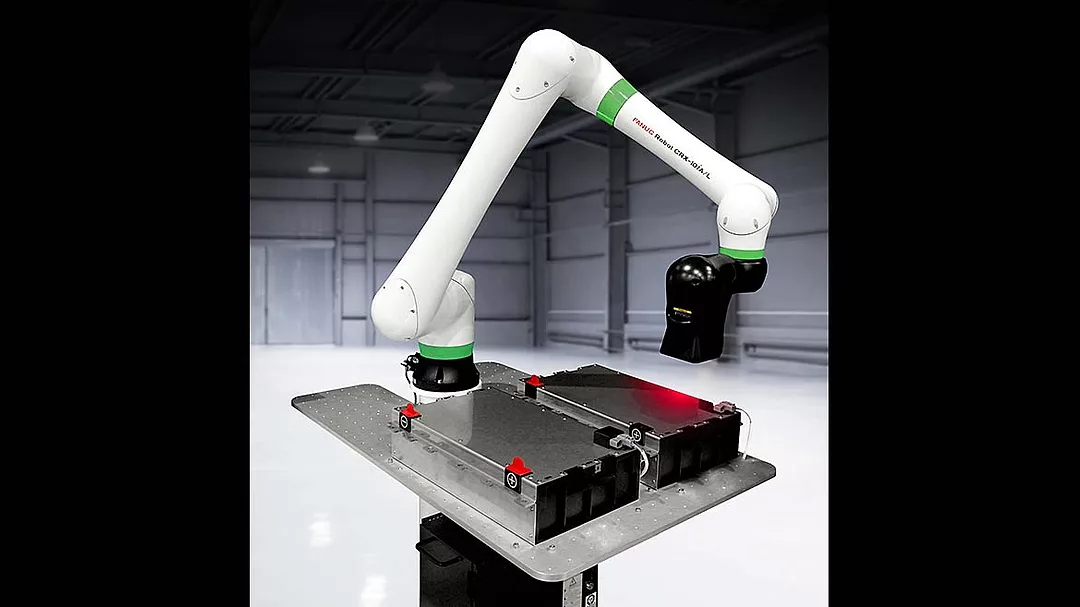

This is a FANUC CRX collaborative robot featuring a lightweight white design with bright green accents.
Image Source: FANUC

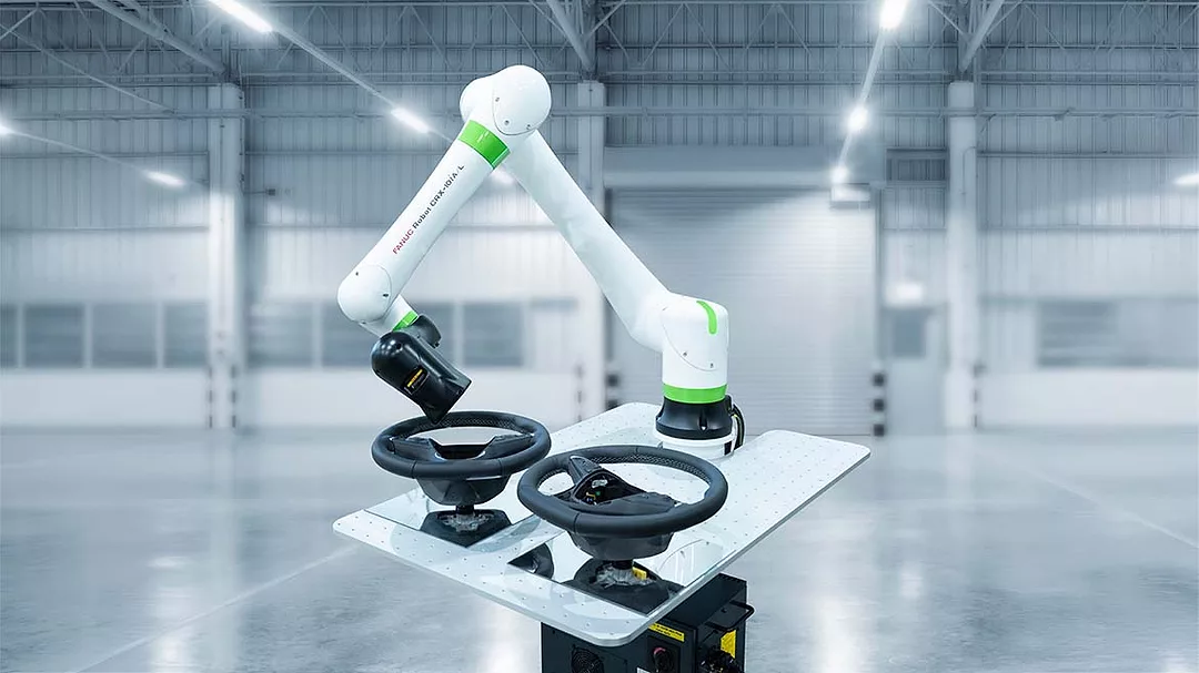

Image Source: FANUC

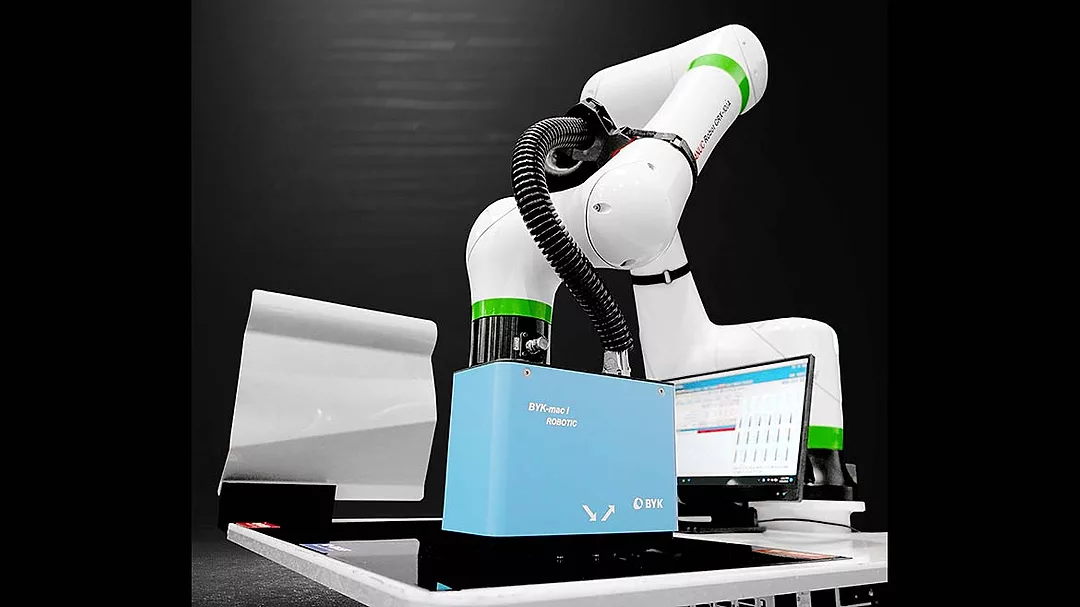

This is a FANUC CRX collaborative robot featuring a white arm with green accents performing industrial automation tasks
Image Source: FANUC

Automated Surface Inspection for Industrial Components
Some standardized systems are designed specifically for surface defect detection on metal, plastic or composite parts. These solutions often integrate high‑resolution cameras and lighting with a cobot that moves the sensor around the part or presents the part to the camera.
Industries such as automotive, heavy machinery, and general manufacturing benefit from:
  • Detection of scratches, dents, and surface anomalies
  • Inspection of complex geometries
  • 24/7 runtime capability
  • AI‑based defect classification for tighter tolerances
These systems reduce the subjectivity of manual inspection and help manufacturers catch defects earlier in the process.

Dimensional and Assembly Verification
Standardized cobot inspection cells can also verify that components are assembled correctly or that critical dimensions fall within tolerance. These systems often integrate:
  • 3D vision for depth measurement
  • Laser scanners for profile verification
  • Multi‑camera setups for complex assemblies
Industries such as electronics, medical devices and consumer products rely on these systems to ensure that even the smallest, most intricate parts meet strict quality standards.
