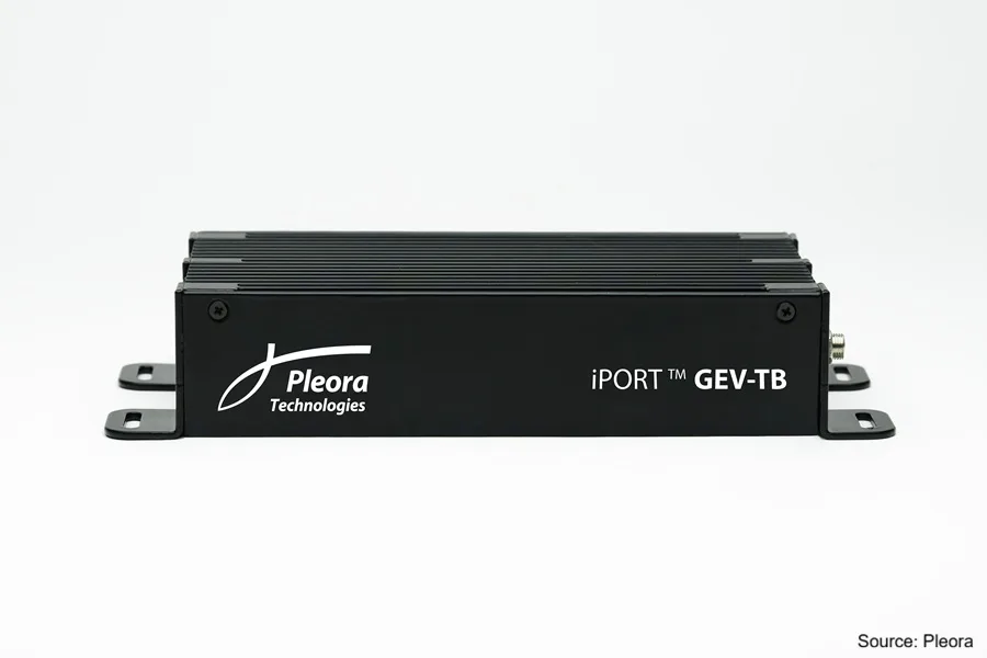

Pleora Technologies announced the launch of the iPORT™ GEV-TB External Frame Grabber, designed to simplify the integration of high-bandwidth GigE Vision® cameras with compact, cost-effective computing platforms while maintaining the performance required for demanding imaging applications.
The external frame grabber converts GigE Vision 2.x camera output into a PCIe stream, transmitting video at up to 22.5 Gbps with low, predictable latency over a standard Ethernet cable directly to a Thunderbolt™ 3/4 or USB4 (USB-C) port. By eliminating the need for a host PCIe slot or internal frame grabber, the solution enables direct connection of high-performance GigE Vision cameras to laptops, embedded PCs, industrial systems, and single-board computers to reduce system size, cost, power consumption, and integration complexity.
A built-in direct memory access (DMA) engine transfers full image data directly to host memory, significantly reducing CPU overhead and freeing resources for application processing. Hardware-based packet resend management and an integrated frame buffer ensure deterministic, reliable image delivery, even in high-throughput or burst conditions. The solution is GigE Vision 2.2 and GenICam compliant and supported by Pleora’s eBUS™ SDK, enabling rapid application development and deployment across platforms using a common API.
“The iPORT GEV-TB External Frame Grabber provides system designers and integrators with a flexible, standards-based solution that extends high-bandwidth GigE Vision connectivity to platforms where PCIe slots are not available,” said James Falconer, Product Manager, Pleora Technologies. “By offloading CPU-intensive tasks and delivering deterministic performance, this solution unlocks new possibilities for portable, high-performance imaging systems.”
