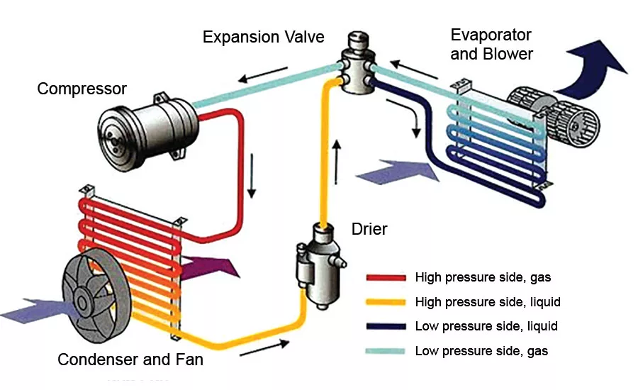

Citing a few examples, in the automotive sector, there are: radiators, evaporators, fuel tanks, fuel caps, and compressors, tire rims, air bag inflators and EGR coolers, all of which require leak testing as part of quality testing. Likewise, in the air conditioning/ heating/refrigeration sector there are: compressors, condensers, heat exchangers, AC indoor and outdoor unit assemblies, pressure control valves, and cooper pipe that all require leak testing. This is just a few examples of an extensive list of products, devices and systems which require leak-tightness.

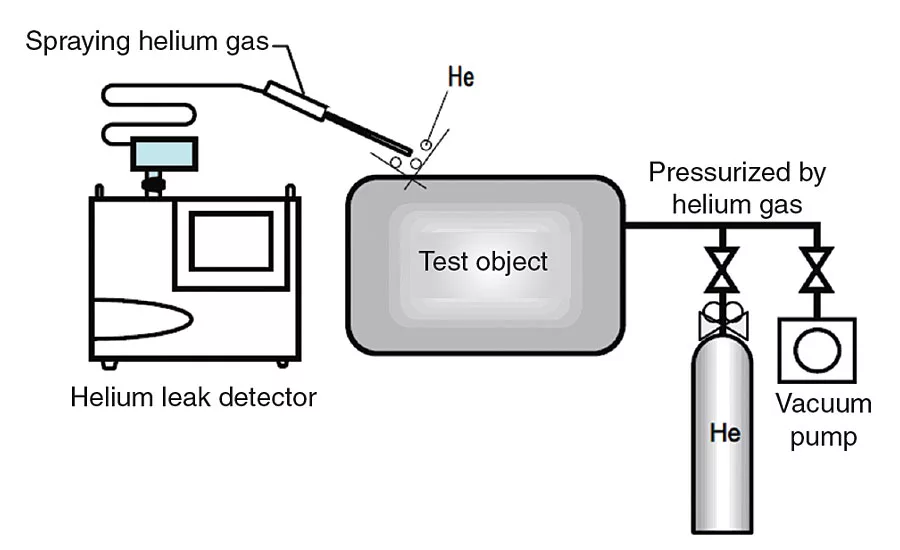

External Pressure Method:
This method involves pumping air out of the workpiece (test object) to create a vacuum, spraying helium gas onto the outside of the workpiece and detecting if helium enters the workpiece with a helium leak detector. Figure 1 depicts the operating schematic for this mode of operation.

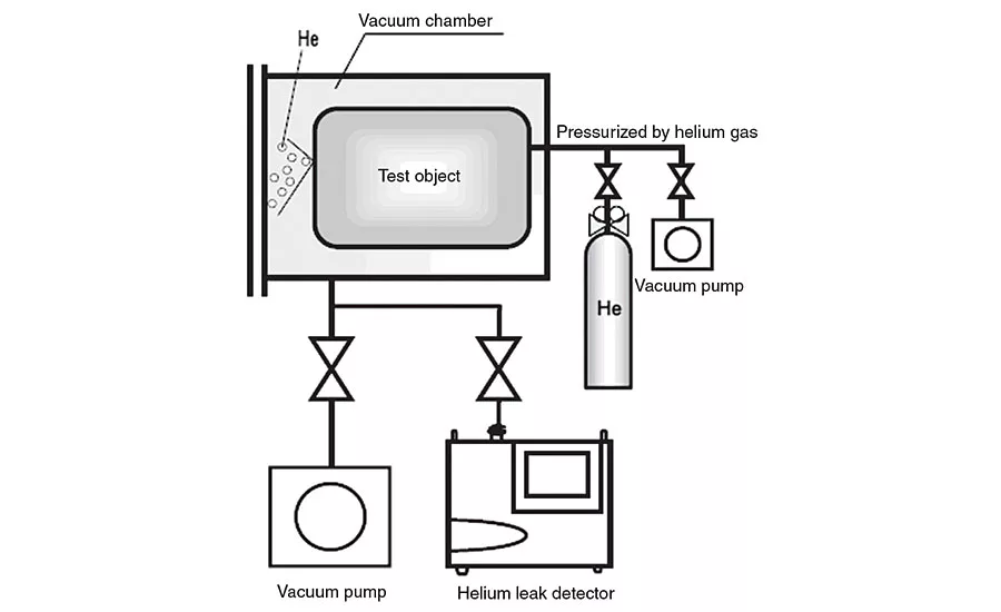

Internal Pressure Method:
This method involves injecting helium gas inside the workpiece in a vacuum chamber, pumping out the vacuum chamber to create a vacuum, and then detecting whether helium leaks from the workpiece into the vacuum chamber with a helium leak detector. Figure 2 depicts the operating schematic for this mode of operation.

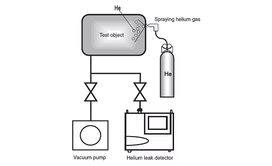

“Sniffer” Method:
The sniffer method involves pressurizing helium gas inside the workpiece and detecting the presence of helium gas from outside the workpiece. Figure 3 depicts the operating schematic for this mode of operation.
