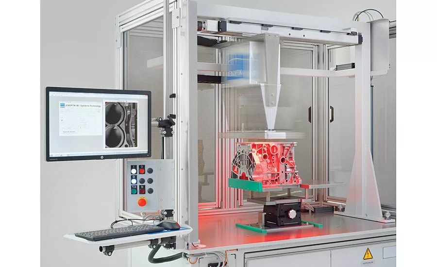

Jenoptik Automotive will introduce the IPS 400 for rapid optical surface inspection of flat machined surfaces. In seconds, the system provides a map of critical surfaces of such machined parts as crank cases, cylinder heads, and valve bodies – critical production parts where surface condition is essential to effective sealing and economical functioning. The system generates the surface image while in motion at high traverse speeds. The inspection area is 400 mm wide, 800 mm long. High speed scanning – 3 seconds over 500mm – assures short inspection cycles and immediate evaluation of part surface condition, alerting management to product quality and manufacturing process capability. Utilizing state of the art CMOS imaging technology, the IPS 400 continuously scans the part surface at high speed, creating a viewable image of the entire machined surface.
