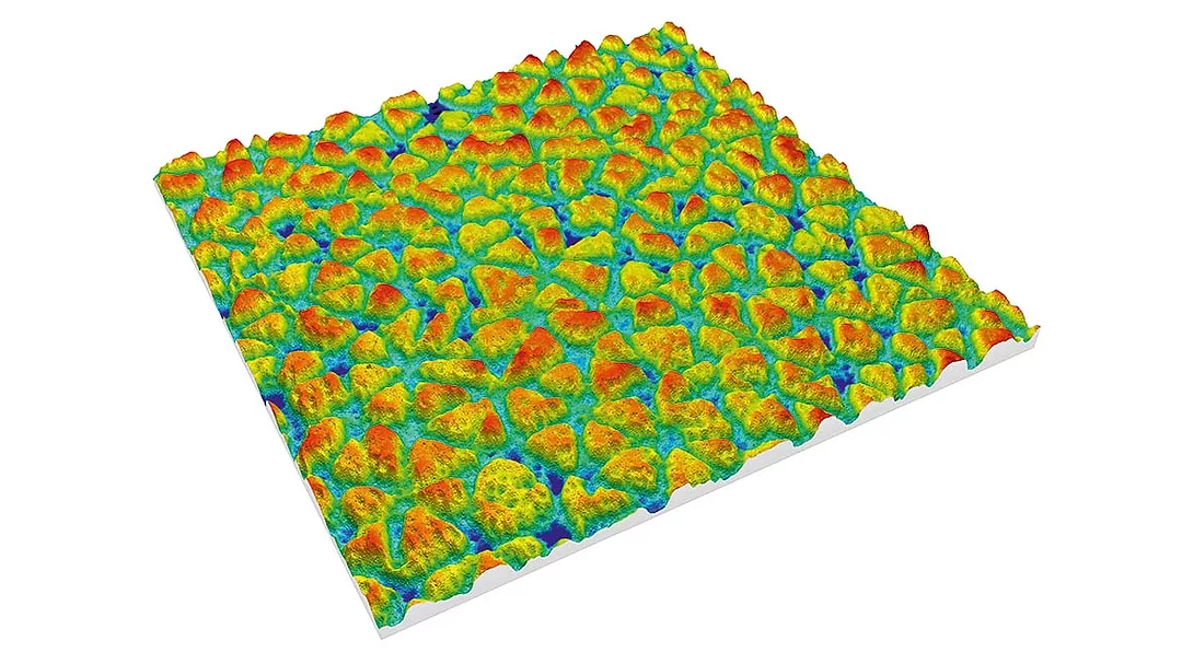

The image displays a surface topography map, likely generated using optical metrology or similar technology.
Source: Mahr

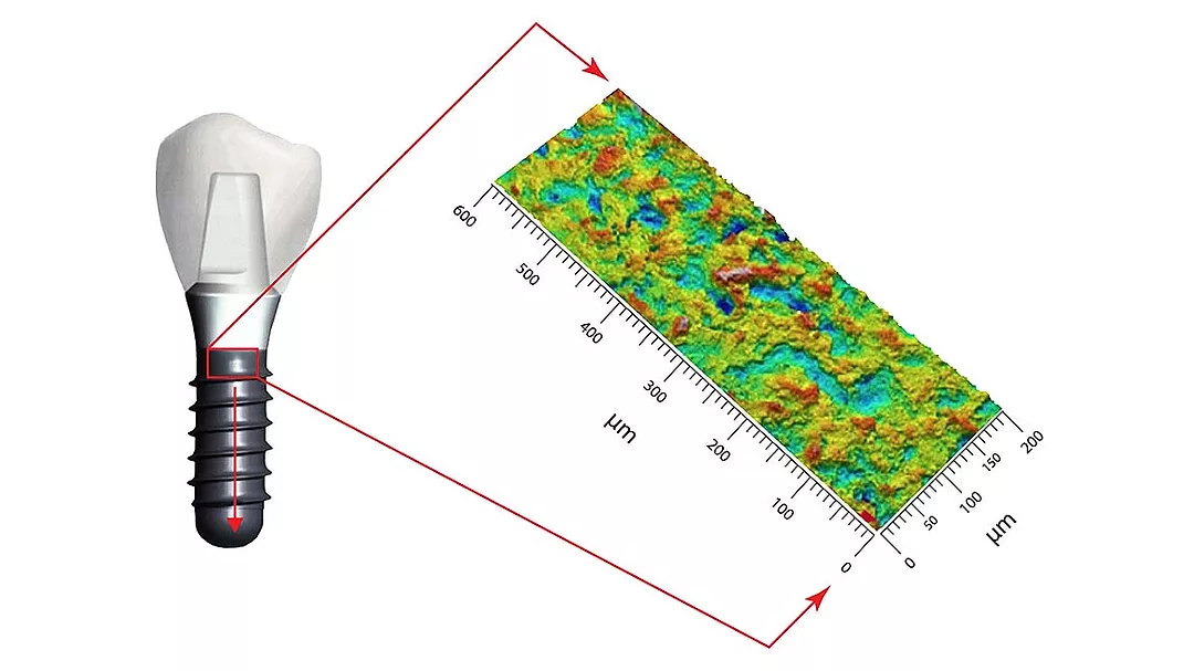

The image displays a 3D surface map of a dental implant's surface roughness, likely generated using a measurement technique like interferometry or confocal microscopy.
Source: Mahr

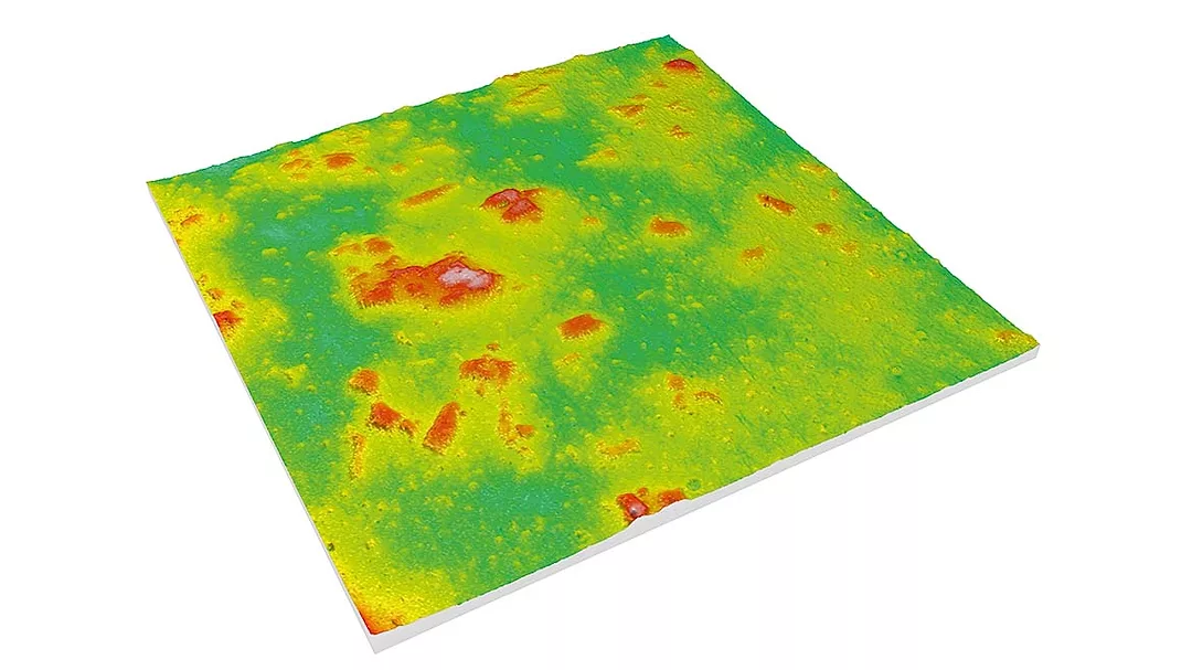

The image displays a 3D visualization of surface texture, likely captured using an optical profiler or laser confocal microscope
Source: Mahr

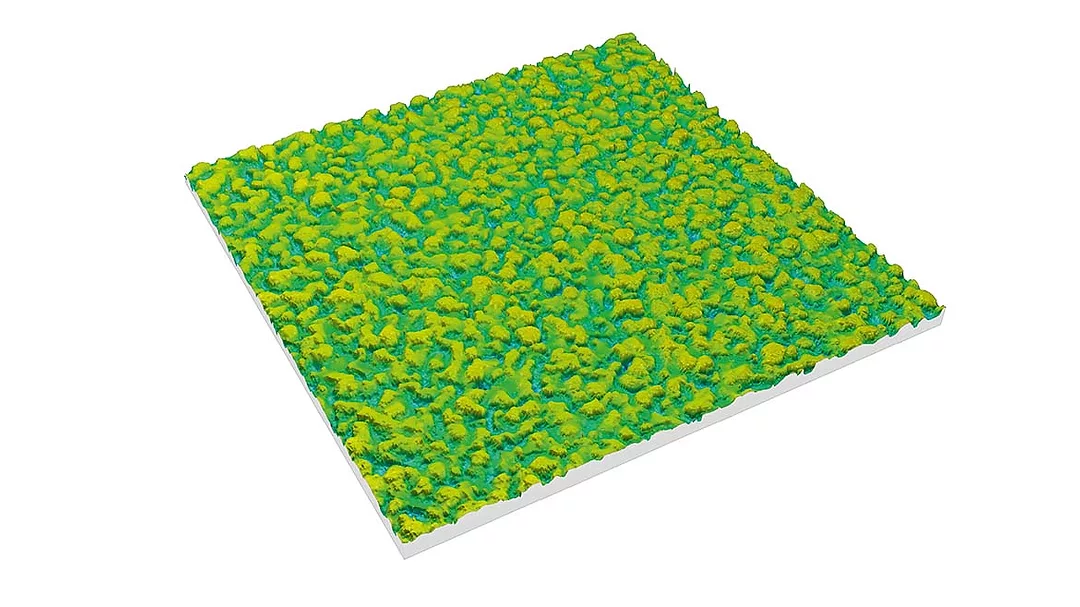

This image displays a 3D topography map of a surface, likely used for analyzing its roughness.
Source: Mahr

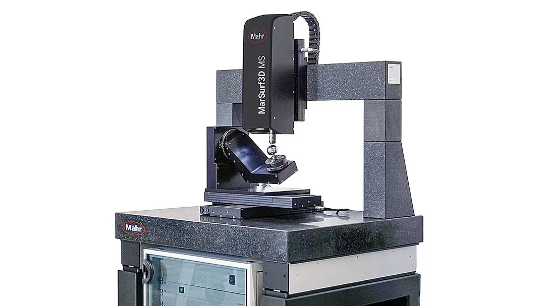

The image shows a Mahr MarSurf3D MS coordinate measuring machine (CMM).
Source: Mahr

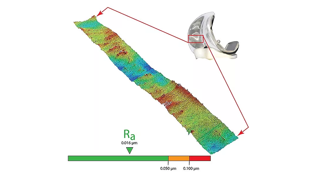

The image illustrates a surface texture analysis, specifically measuring the roughness parameter "Ra" on a metallic orthopedic implant.
Source: Mahr

A New Era of Flexibility: Multi-Sensor Solutions
A significant trend in optical surface metrology is the shift from single-sensor tools to a new generation of multi-sensor, configurable tools that feature noncontact, five-axis motion-control positioning within a single system, enabling the combination of different measurement techniques in a single instrument.
These systems offer greater flexibility and versatility, serving as powerful tools for medical device manufacturers to measure a wide range of surfaces and materials with high accuracy and precision.
Innovative new multi-sensor approaches integrate five distinct sensor types:
  1. LED Confocal Microscopy
  2. White Light Interferometry (WLI)
  3. Multi-Sensor Trio: Combining Confocal, WLI, and Focus Variation in one head.
  4. Confocal Rastering Point
  5. Confocal Line
The Power of Integration: Hardware, Software, and Automation
By integrating various sensor types, such as LED confocal microscopy, white light interferometry (WLI), focus variation, and both confocal rastering point and line sensors, these systems can analyze surfaces more holistically. However, the sensor is only as good as the machine carrying it. True “surface fidelity,” representing the surface exactly as it physically exists, requires three pillars:
Hardware Integration
The integration of multiple sensors and peripheral hardware, including high-precision X, Y, and Z axes, and CNC motion control, ensures the sensor moves with absolute stability, enabling seamless measurement and analysis.

Use Case: Ensuring the Comfort and Efficacy of Surgical Implants
Orthopedic implants for hip replacements provide a clear example of the applicability of optical surface texture measurement. In this type of surgical implant, two components with different functional surfaces work together to recreate the ball-and-socket structure of the hip joint. This includes a dynamic surface, a femoral head, which can move, e.g., slide or rotate while in service. This type of implant has very tight tolerances and incorporates highly polished surfaces.
The second component, the femoral stem, requires extremely rough and complex features that bones can grow into and adhere to. How well the bone can do so depends on the surface roughness and the surface area available for bone growth.
By measuring surface texture, medical device manufacturers can ensure implants have the desired characteristics, such as smoothness, appropriate roughness, and optimal friction properties. These factors are crucial to the implant’s ability to articulate smoothly with surrounding tissues and to provide long-term stability and functionality.
