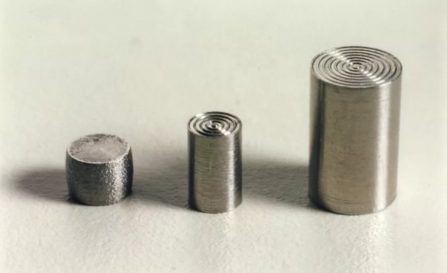

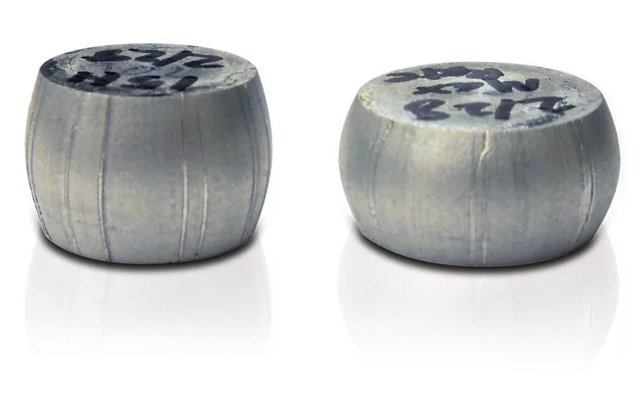

Reviewing and managing potential variables is especially important with compression testing, which by nature makes specimens want to behave differently when even the subtlest of variables is introduced. Put another way, it is much harder to squish something in a repeatable manner than to pull it apart. Try pushing a rope together five times the same way versus pulling it apart five times, for example. Therein lies the difference between tension and compression testing.

Very few compression tests involve specimens that are perfectly round or square. Poor control of specimen and grip angularity and concentricity means that compression tests are not pushing in the center of the specimen, nor are they pushing straight down on specimen ends. Unequal specimen lengths and widths are the norm, which makes test system alignment critically important to support repeatable testing and produce consistent test data.
For example, cylindrical test specimens want to buckle inconsistently when compressed—and if a test system is even slightly out of alignment, the compressed specimen may look more like a leaning tower and less like a hockey puck. Paying close attention to alignment before testing will help keep throughput high.

Many compression tests begin in a linear fashion but become nonlinear as a specimen begins to crush, crinkle or yield. If your data acquisition rate is less than sufficient, you might miss this important transition when trying to determine bend or compressive yield, for example. Combining “level crossing” and “timed” data acquisition may provide superior results.
