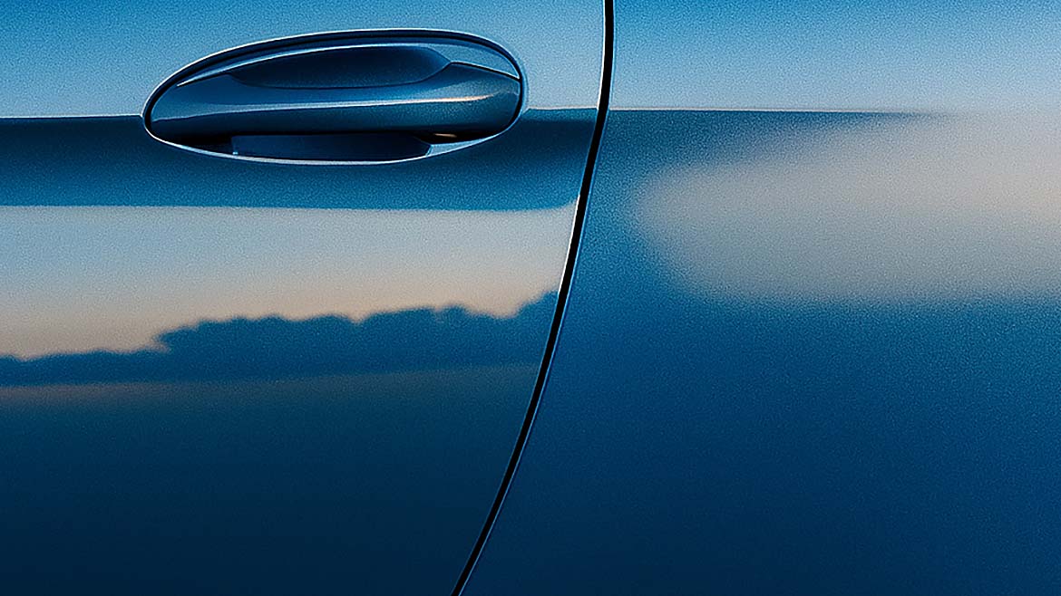

Gloss Haze comparison
Image Source: BYK-Gardner USA

Haze
Reflection haze is the additional scattering of light that reduces clarity or sharpness of the surface.
As light interacts with the surface or coating, it can scatter resulting in a milky effect and increase haze. This effect can stem from a variety of factors, ranging from formulation to application, resulting in reduced perceived quality of the final product. The reflection haze or DOI can be measured to quantify the quality of the reflected image. The measurement principle of these instruments is to quantify the sharpness of the reflective image correlating to our visual impression of the surface quality.
