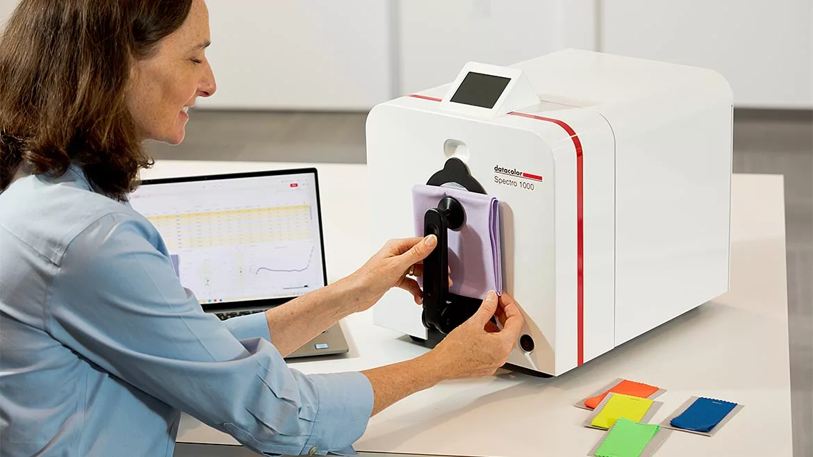

Woman using the Spectro 1000

Color measurement instruments provide reliable and consistent benchmarks for QC and formulation software. Spectrophotometers can read wavelengths of light to create a unique reflectance curve. This measurement effectively provides a “fingerprint” for the color, enabling extremely predictable matching. Reflectance curves can be stored in an electronic file format known as QTX, which can be used to import color measurement data into QC software or exchanged with supply chain partners.
Color measurement instruments come in various configurations, each designed for different needs and budgetary levels. Three common ones are:
  • Benchtops — The most accurate instruments, primarily used in labs and other stationary environments
  • Portables — Capable of being moved around a plant or in the field for a variety of applications, often used on production lines
  • Color lookup — Small and inexpensive units ideal for retail and consumer markets
The more precision you need, the more you’ll benefit from higher-quality instruments. You’ll also want to ensure the instruments you’re using have close inter-instrument agreement with those used by your vendors, customers and partners.
