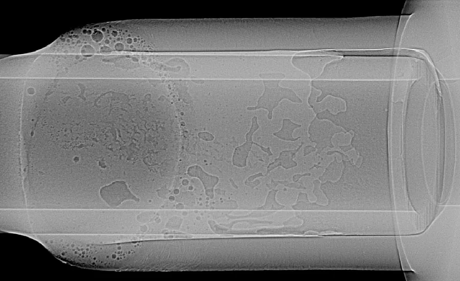

Tubing Braze joint evaluation is an application where superimposed data makes 2D image interpretation difficult. See Figure 1. When two static views are provided, it can be difficult and time consuming to track the travel of multiple indications during the rotation. A miss-tracking of an indication can mean the difference between accepting or rejecting a part.

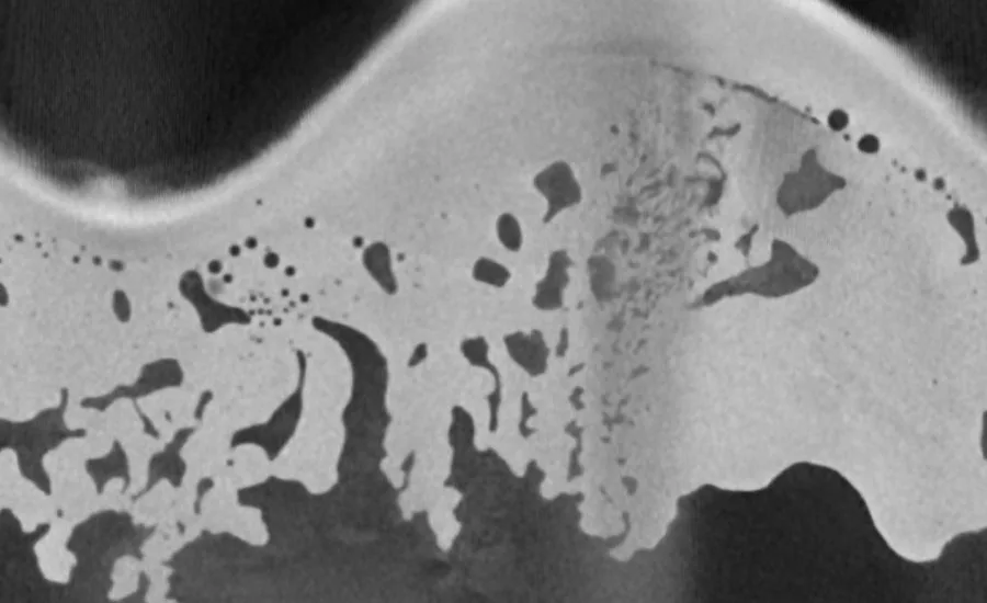

With CT, data from cylindrical products such as tubing braze joints and welds can be “unrolled” in software to produce a view of the data as if the tube had been cut and rolled out flat. (See Figure 2.) At this point, conventional 2D acceptance criteria can be applied. The obvious benefits are:
  • No superimposed discontinuities
  • Much faster interpretation times
  • Ease of discontinuity measurement
  • Better understanding of the true braze coverage
  • Higher probability of detection and an accurate interpretation

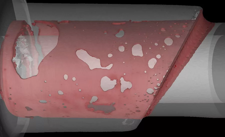

Braze material and nickel tubing can be segmented and displayed together or independently. (See Figure 3.) The segmentation can be rotated providing a full 3D view of the entire braze joint. Automatic software void analysis and percentage of coverage routines can be applied based on 3D acceptance criteria.

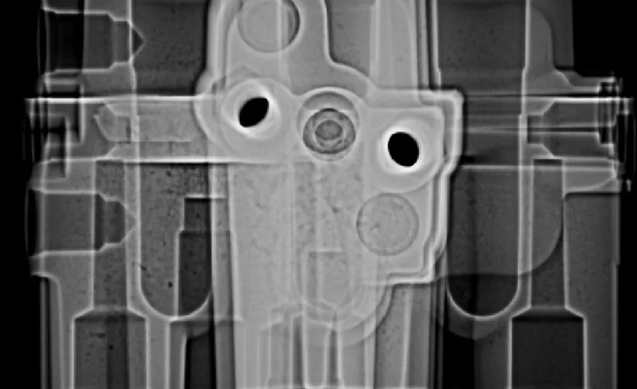

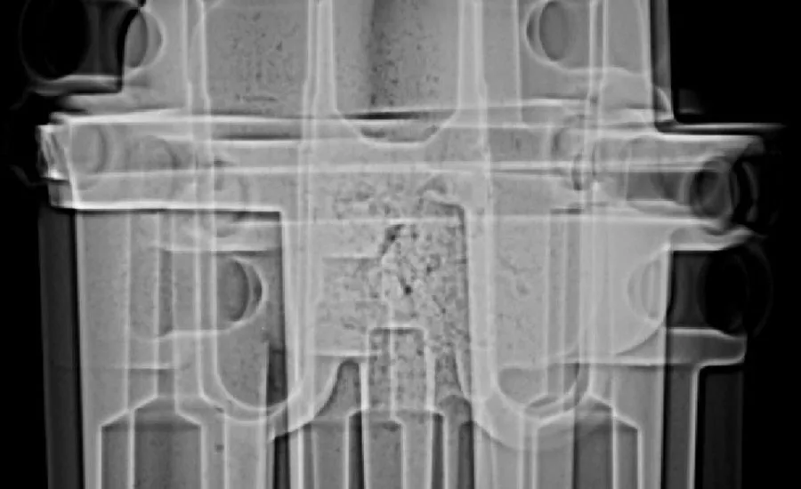

For some complex geometry castings, the product features and multiple discontinuities become superimposed on top of one another making interpretation extremely difficult even with two or three static views. (See Figure 8.)

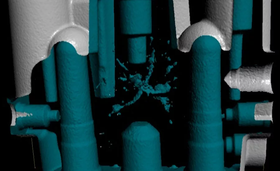

Surfaced CT Volumes Provide high quality 3D Visualization and Automatic Void Analysis Opportunities.
Various size voids along with large cavities are clearly visible in the center of the casting. (See Figure 9.)
The probability of detection increases significantly when using 3D visualization tools. This data can also be directly compared to machining drawings using software tools to identify what discontinuities may be removed during secondary machining operations.
