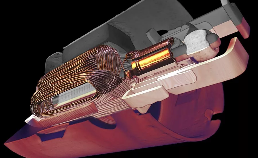

Another application of CT is in the area of metrology. Many product designs take on complex geometries with internal features and chambers that are not accessible for conventional measurements methods such as contact coordinate measurement machines (CMM). CT is now successfully solving this problem in many applications and is used to retrieve internal and external metrology data for product acceptance, while also providing data in monitoring build variability within a specific manufacturing process (See Figure 13). Automated software routines can be setup to provide multiple feature measurements while also performing automated routines for component placement of assemblies as well as product integrity evaluations such as porosity analysis.
CT Scanning
CT Scanning
Figure 13. CT is now successfully solving this problem in many applications and is used to retrieve internal and external metrology data for product acceptance. Source: North Star Imaging Inc.
