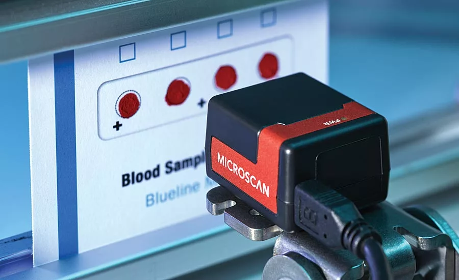

Packaging, electronics, automotive, clinical diagnostics… Smart cameras have made their way into all sorts of industries and applications. Machine vision engineers never get to rest on their laurels because there’s always some new process to improve. Today’s smart cameras need to be modular, scalable and customizable—as well as exceptionally powerful and high-performing—to meet ever-increasing demands in automatic identification, machine vision, quality inspection, robot guidance and automation in general.
Fortunately, there are many ways that today’s smart cameras can be designed to be versatile and powerful at the same time. From lights to lenses to processing technology, machine vision experts have multiple opportunities to enhance flexibility while maintaining speed and performance.
