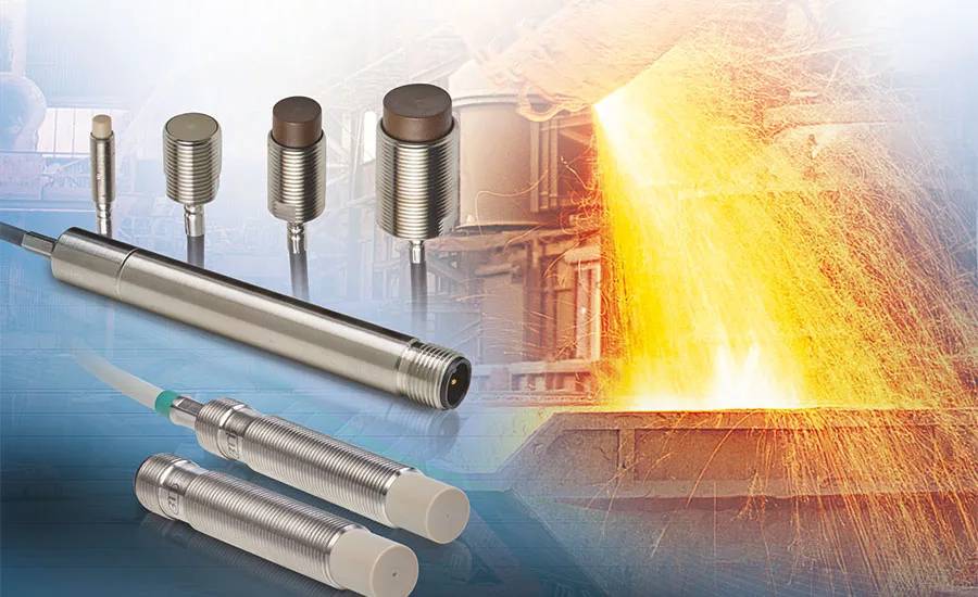

Eddy current sensors
Eddy current sensors provide a “clean performance” in dirty conditions
Unconditional precision
Eddy current sensors offer extremely precise measurements and are used where micron accuracies are required. In order to ensure high measurement accuracy even with fluctuating temperatures, the sensors are actively temperature-compensated. Ambient temperature fluctuations are one of the critical factors that influence the accuracy of measurement results. In terms of temperature fluctuations, there are basically two factors that influence the measurement signal. These are mechanical changes, where the geometric dimensions of the sensor and the target change in the form of extension or contraction. Alternatively, there are electrical influences that have a greater impact than mechanical changes. In this case, the electromagnetic characteristics also change. Active temperature compensation can be used in order to improve temperature stability. In complex processes, the effects of temperature fluctuations are accounted for. Being used in ambient temperatures from -40 C to more than +200 C, eddy current displacement sensors are robust against temperature fluctuations. The design and active temperature compensation provide these sensors with an extremely high temperature stability.
