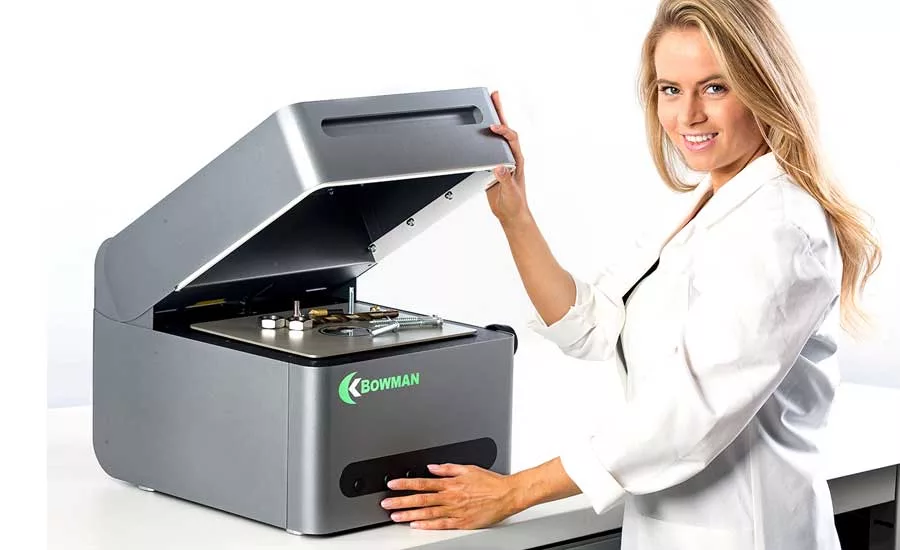

This “bottom-up” XRF uses a motorized Z-axis with laser auto-focus.

Z Protection with laser scanner
As samples are positioned on the X-Y-Z stage, the scanner’s laser powers up and scans for intrusions; it stops when the laser detects the sample. The process then repeats to cover the remaining sections of the stage. The table retreats to the highest point at which it stopped, and executes a slow scan, establishing the Z travel range. The X-ray head approaches this position, and the “No Part Loaded” message switches to “ready,” signaling the process is complete. Subsequently, the head will be unable to move below the position where the sample was located, preventing contact by restricting Z axis travel.

Laser Auto Focus
When measurement tasks were simpler, optical focusing was sufficient for positioning samples. Today, with the definition of “precision” continuing to evolve, the roughness of a sample surface often creates an issue, since it easily confounds the auto-focus of an optical device. Technology’s answer is the laser focus. When activated, all of the lights in the unit turn off, and the software seeks the center of the laser which is calibrated at a fixed angle to define the working distance. When located, the software moves the Z-axis to the center of the laser for precise and consistent measurement distance. This feature ensures that samples are within a few microns of the in-focus position for greatest accuracy. Bonus: it does so in two seconds or less.
