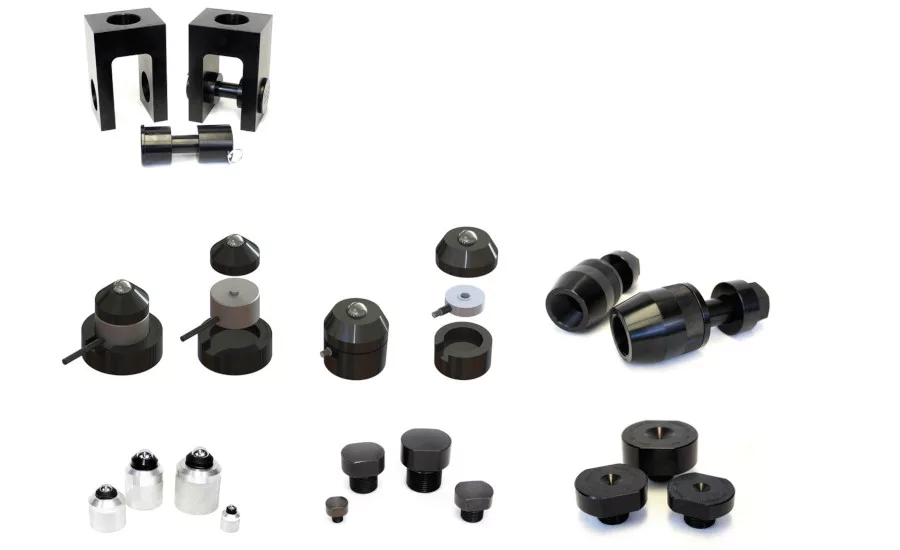

Common Adapters to Reduce Force Measurement Error
Keeping the line of force pure (free from eccentric forces) is key to the calibration of load cells. ASTME74-18 in note 5 states “Force-measuring instruments have sensitivity in varying degrees depending on design to mounting conditions and parasitic forces and moments due to misalignment. A measure of this sensitivity may be made by imposing conditions to simulate these factors such as using fixtures with contact surfaces that are slightly convex or concave, or of varying stiffness or hardness, or with angular or eccentric misalignment, and so forth. Such factors can sometimes be significant contributors to measurement uncertainty and should be reflected in comprehensive measurement uncertainty analyses.” ISO 376 has an entire Annex devoted to adapters.
Typical tension member assemblies
Tensile force transducers
Figure 3: Typical tension members. Tensile force transducers should be fitted with two ball nuts, two ball cups.
A good start to what makes a good tension or compression adapter is the ISO 376 standard. Annex A.4.1 of the ISO 376 standard says “Loading fittings should be designed in such a way that the line of force application is not distorted. As a rule, tensile force transducers should be fitted with two ball nuts, two ball cups, and, if necessary, with two intermediate rings, while compressive force transducers should be fitted with one or two compression pads.” Figure 3 above shows typical tension adapters that have two ball nuts and two ball cups built into them to align the load cell with loading line and eliminate misalignment errors in tension calibration.

Proper bottom alignment adapters help to align a load cell and other calibration fixtures to the load line of the calibrating machine. No matter how good an operator may be, human skill is not a substitute for something machined with precision. By having bottom adapters with concentric rings for alignment or alignment plugs to perfectly center the force-measuring instrument, the end user is going to be able to reduce misalignment error. Misalignment errors of up to 0.75 % on S-Beam load cells with less than 1/8” misalignment have been observed. Alignment plugs and base plates with alignment holes in figure 6 drastically reduce this error.

For the top of the load cells, it is recommended to load with either a spherical or ball adapter pictured in figure 7. In compression, using a ball adapter (pictured top right), if the machine has one, often yields the best results. If a ball adapter does not exist, a spherical alignment adapter (pictured top left) will help align the force. Use a spherical alignment adapter for any load cell that is not a shear web load cell with a female thread that needs to be calibrated in compression. For a shear web load cell, install the integral threaded adapter. The shear web load cell is very susceptible to varying thread engagement and the integral adapter eliminates this error. For those that still need to use a shear web type cell and have height restrictions, a spherical adapter is recommended, but will not produce results as good as an integral threaded adapter.

The number one challenge with button and washer load cells is how to get them to repeat between rotations. These load cells are notoriously sensitive in rotation and any misalignment will produce large errors. Above are pictures of typical button and washer load cell adapters that improve alignment and yield better calibration results. Usually the results are better by a factor of five when using the above adapters, as compared with a technician trying to center as shown in figure 9 below. These adapter sets can also accommodate alignment plugs (Figure 6) to align the whole calibration setup with the calibration machine; a deadweight system, hydraulic Universal Calibrating Machines (UCM), or a Portable Calibrating Machine (PCM) offered by Morehouse.
