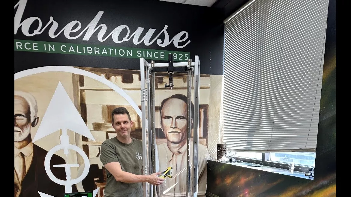

How to Calibrate Cable Tensiometers: The Right Equipment
Henry Zumbrun performing cable tests.
Figure 1: Henry Zumbrun performing cable tests.
The right equipment may also consist of cables of at least three feet or greater free from defects. That means the cable should lie flat and not have any bends or kinks. Some systems use cables that are 18 – 24 inches, and these shorter cables can lead to different results.
Some of these systems even use torsion cells meant to calibrate torque wrenches. Torque equipment used to calculate the force on a cable typically utilizes shorter cables and is likely not the right equipment. This approach is complicated by the calculation of force from a torsion cell and introduces measurement uncertainty and error components that are extremely difficult to quantify and often quite large.
For calibrating any cable tensiometer, it is essential to read the manufacturer’s recommendations, which often include cable lengths and types.
These are key features that can ensure accurate and reliable tensiometer calibration:
  • Minimized Strain: A load cell positioned at the base eliminates the influence of any extra strain caused by hanging and clamping the tensiometer.
  • Precise Frame: Make sure the frame is meticulously designed to be plumb, level, square, and rigid, minimizing torsion and offering exceptional control during calibration.
  • Versatile Calibration: We recommend a machine that allows for two calibration methods: clamping and adjusting the tension, pre-loading the cable to a specific value, and clamping. We recommend cables up to 5 feet long and that generate tension forces as high as 2,000 pounds-force (lbf).
This combination of features includes minimizing strain, utilizing a precise frame, and offering versatile calibration methods to calibrate tensiometers. When evaluating the right equipment, one may want to investigate frames with versatile calibration options.
