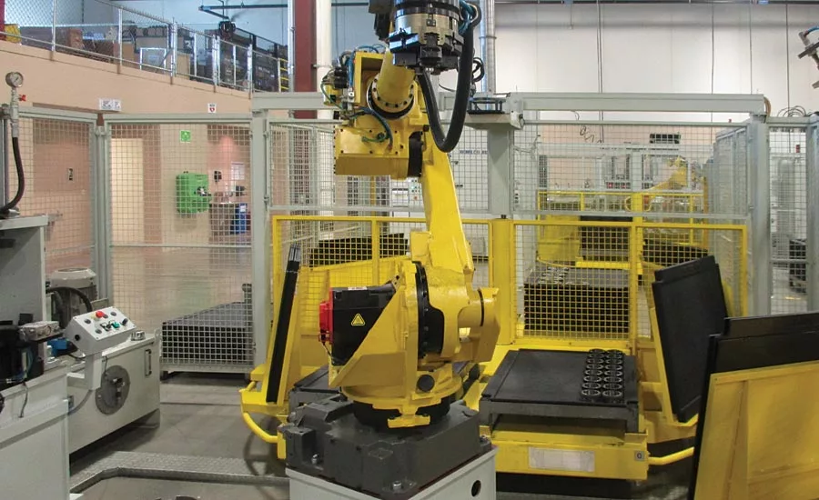

Somaschini North America has fifteen robots deployed across nine automated cells at its South Bend, IN, facility.
