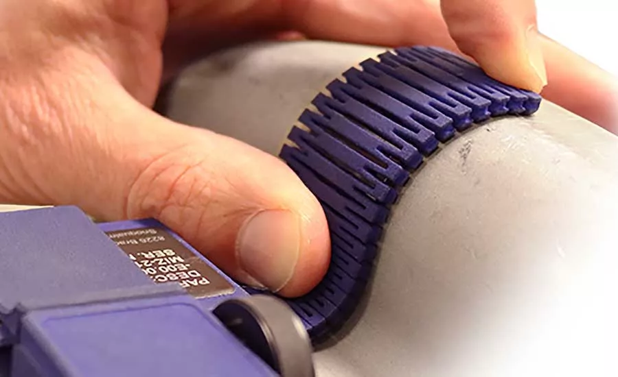

Flexible ECT probes
Flexible ECT probes allow the coils to bend and remain close and nominally perpendicular to the surface.

One practical limitation of ECA technology is that as the operator moves the probe across the surface under test, the excitation coils need to be close to the material for accurate flaw detection and signal quality. It can be a challenge when you’re dealing with complex geometries, different weld shapes and materials, rough surface conditions, and inspection areas that are difficult to reach.
Consider the inspection of a circumferential butt weld joint on a pipe, where the positive curvature of the pipe exterior, the positive curvature of the circumferential weld crown bead, and the negative curvature of the joining area at the toe of the weld intersect. It’s a good example of a complex geometry: the joint between the weld and the base material is difficult for an eddy current probe to reach because of the planar nature of typical array assemblies. In addition, the weld itself is a non-uniform surface.
Thus, there is a need for a probe design that can keep the excitation coils and sensing devices, whether coils or other sensors, closely and properly aligned with the surface of the material as the operator slides it over the surface. Over the years, probe suppliers have come up with a variety of methods to accomplish this.

Flexible Probes
Another approach is to use an ECA probe with a flexible, durable wear surface that allows the coils to bend and remain nominally perpendicular to the surface when that surface is rough, irregular, or complex. In the case of a non-ferromagnetic weld, for example, a flexible surface array probe with just two inches of coverage can encapsulate the weld bead, transition zone, and heat-affected zones in a single pass.
Because this type of flexible probe can conform and adapt to different surfaces and contours, it can handle a range of ECA inspections on the same job ticket: for example, a technician on a flight line can inspect rivets on a curved wing, weld joints on turbine rotors, and the multi-layered skin of a fuselage with the same flexible surface array probe.
One important consideration is the material on the wear surface. The thickness of the wear surface will affect the proximity of the coils to the material as well as the probe’s overall flexibility and eddy current signal quality.
In some cases, the flex circuit may not be durable enough to withstand repeated abrasion against potentially rough metal surfaces. Probe manufacturers offer a variety of materials as a wear surface, including plastic films and abrasion-resistant fabrics. The wear surface may be separate from the flex circuit, which allows it to be easily replaced, or bonded to it, in which case they would need to be replaced as a unit when necessary.
