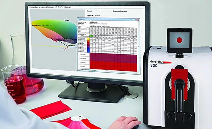

Datacolor 800 spectrophotometer
The Datacolor 800 spectrophotometer measures color onfabric swatches. Source: Datacolor
