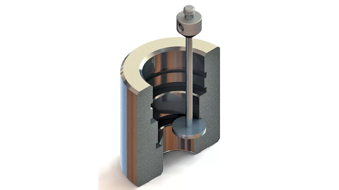

Disk styli are generally used to probe internal diameters, especially ID grooves, like O-ring seats. Disk styli are widely used to inspect hydraulic components. (Figure 3) They’re also useful for larger bore diameters because a large diameter disk can reduce overall axis motion and thus speed up inspection throughput. Disk styli can be used on measuring machines equipped with either tactile (point-to-point) or continuous scanning probe heads.

Figure 3: Inspecting an O-ring grooveImage Source: Q-Mark Manufacturing
