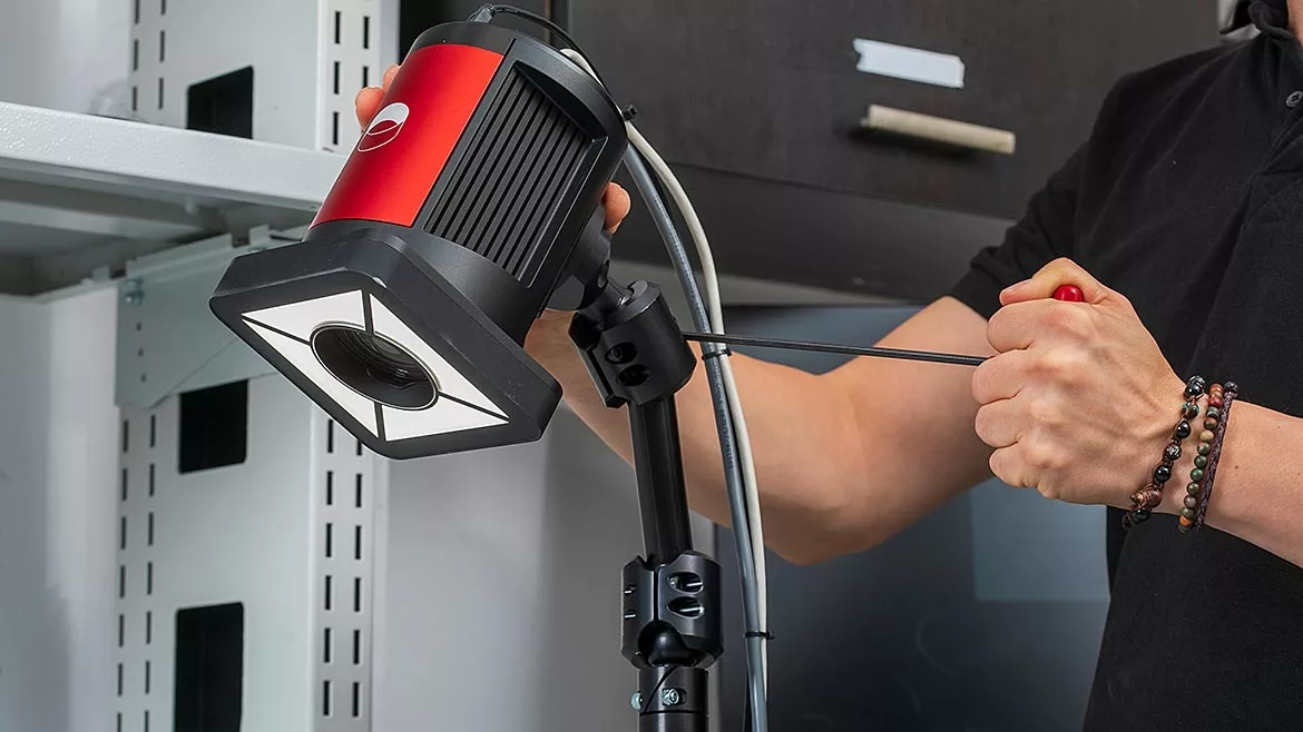

QM 0222 Test & Inspection Technician with the INSPEKTO S70 Gen 2
Components are getting smaller and quality standards stricter, while production environments are more fluid, and consumers’ demands change. This has led many manufacturers to seek machine vision solutions to conduct visual inspection tasks. Source: Inspekto
