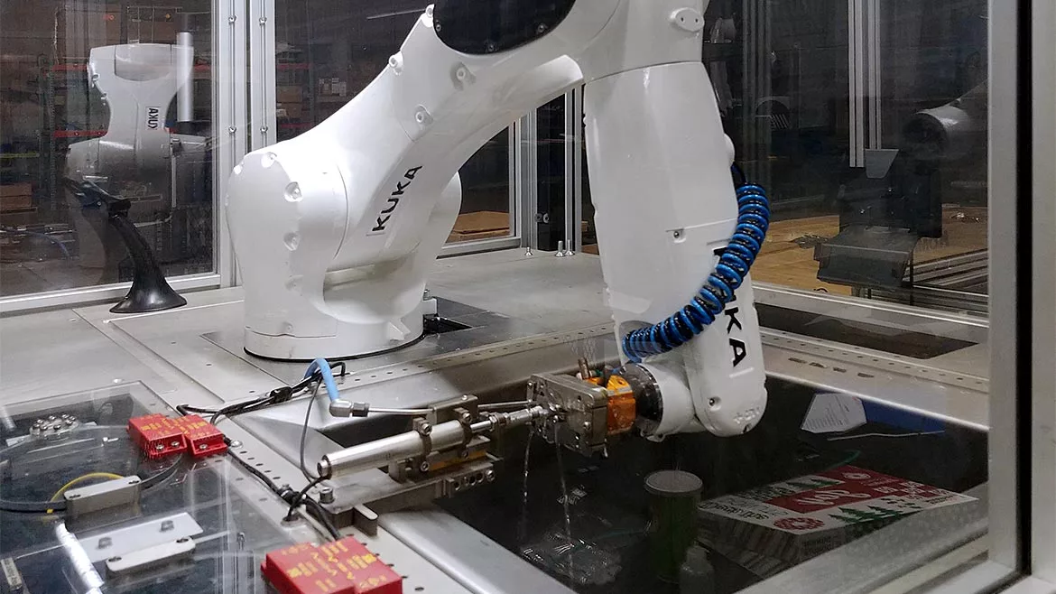

Automated robotics are the best way to mimic a human in a factory environment, experts say. A robot's automated camera could replace a person's eyes, a PC would represent the brain and robotic arms are movement — like "a human replacement that doesn't get tired or moody," says Adrian Ng, senior sales, Cortex Robotics Sdn Bhd.

Mickey has noticed robots being used for machine tending, both loading and unloading/palletizing.
"Many cells might simply have an operator provide a cart full of parts, and a second empty cart," he says. "The robotic system will pull product from the supply cart, load and unload the machine tool, present the machined part to various secondary systems, and then pack the part on the previously empty unload cart," he says. Between the robotic automation and the tool changer within the CNC, "you have a pretty much ‘lights out' operation," he explains.
