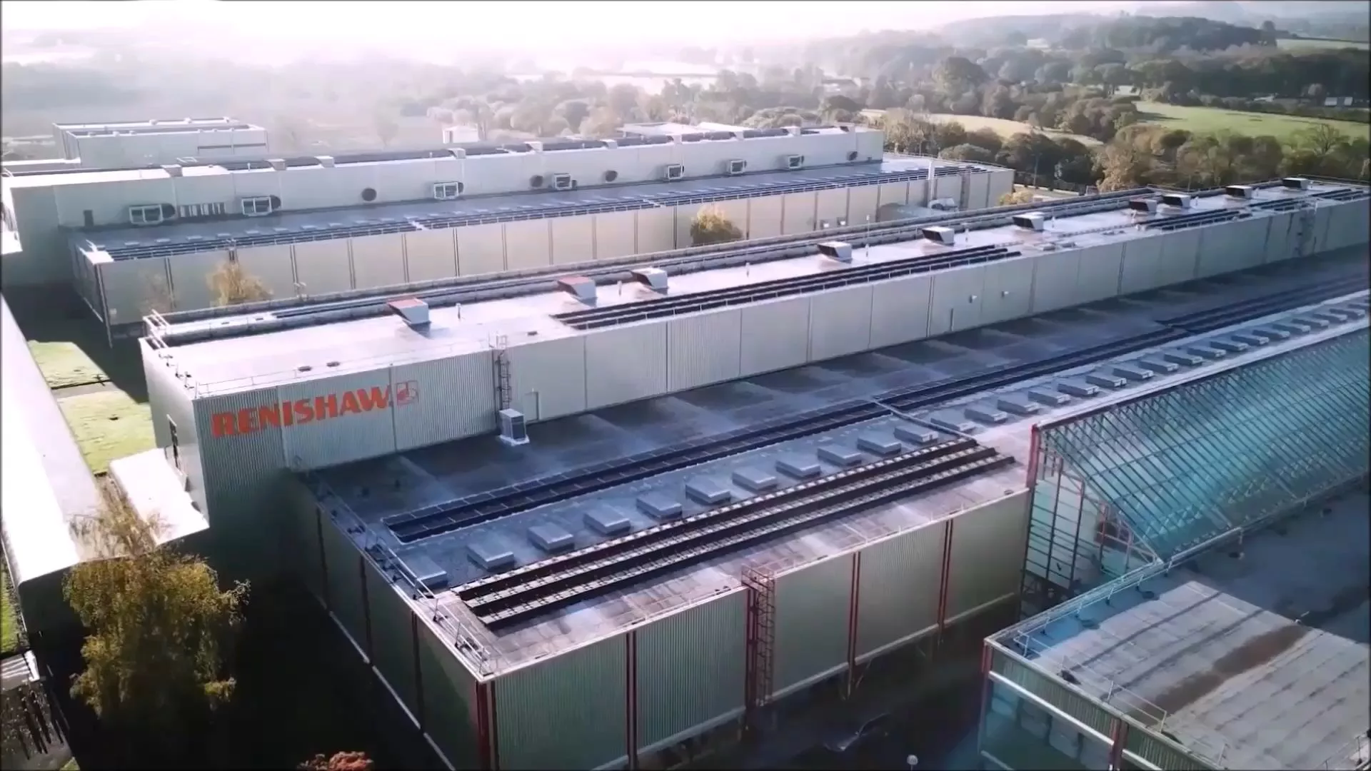

A vital consideration for the new construction program at the Miskin site, is to ensure that this new target can be achieved. Therefore, the new facilities will be built with the latest technologies and materials to ensure that they will be Net Zero in operation, and the build also aims to minimize the amount of embodied carbon within the building materials used in construction.
By the end of 2024, Renishaw also aims to have refurbished the two existing production halls at Miskin to reduce their carbon emissions, including new energy-efficient cladding and the replacement of existing heating systems.
These sustainability investments complement initiatives at Renishaw’s other global sites, including large investments in roof-mounted solar panels, new car port solar panels, EV charging points to support the Company’s move to ultra-low emission (ULEV) fleet vehicles and a new ULEV salary sacrifice scheme, initially for its UK employees, and feasibility studies to assess the viability of wind power.
