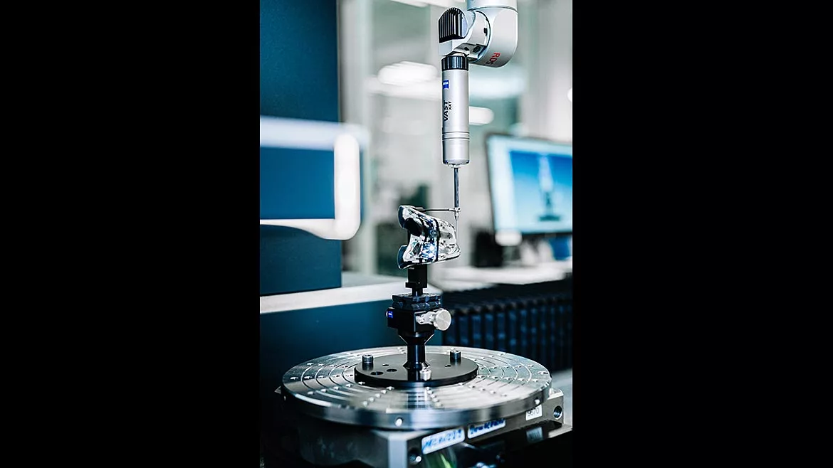

The CMM hardware alone is not the only aspect subject to validation.

The specific intended use of the CMM is to facilitate accurate, repeatable measurements of medical device components (or other workpieces) within the manufacturer’s given environment (an inspection lab, production area, etc.). This intended use gives rise to a number of requirements, including:
  • The requirement that the CMM performs to an expected level after being installed in the manufacturer’s environment
  • The need for it to be traceable to national standards
  • The need for the CMM’s environment to be suitably controlled with regards to temperature and humidity
  • The requirement that CMM users are trained to operate and maintain the CMM system.
Given such requirements, it’s clear that the CMM hardware alone is not the only aspect subject to validation. Realistically, it is the "CMM system" — the collection of CMM hardware, environment, users and other related infrastructure — that addresses the intended use. "Generic" documents like CMM accuracy specifications are not, by themselves, sufficient to proclaim that a CMM is validated, although they are important.
