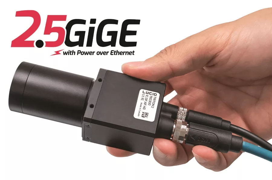

Lucid Vision Labs, Inc. announced the expansion of its Triton2 camera series featuring the latest Sony Pregius S sensors with a 2.5 GigE interface.
The Triton2 camera family utilizes Sony’s Pregius S global shutter CMOS image sensors, offering a diverse range of resolutions from 1.6 MP to 24.5 MP. With this expansion, Lucid introduces four new Triton2 camera models that have now entered series production. The image sensors in these models include the 1.6 MP Sony IMX273 running at 166 fps, the 2.3 MP IMX392 at 116 fps, the 5.0 MP IMX264 at 35 fps, and the 12.3 MP IMX304 at 22 fps. Additional models are planned for release later this year.
Triton2 leverages Lucid’s trusted Factory Tough™ industrial platform, delivering unparalleled performance within a compact, cost-effective, and uncompromising camera design. The adoption of the 2.5GigE (300 MB/s) interface enhances bandwidth, while retaining the benefits of a compact size, efficient thermal management, and Power over Ethernet (PoE) support.
Designed for seamless integration, the 2.5GBASE-T Triton2 enables rapid data transfer rates of 300 MB per second and supports standard CAT5e and CAT6 cables up to 100 meters.
All Lucid cameras conform to the GigE Vision 2.0 and GenICam3 standards and are supported by Lucid’s own Arena software development kit. The Arena SDK provides customers with easy access to the latest industry standards and software technology. The SDK supports the Windows, Linux 64-bit and Linux ARM operating systems, and the C, C++, C# and Python programming languages.
